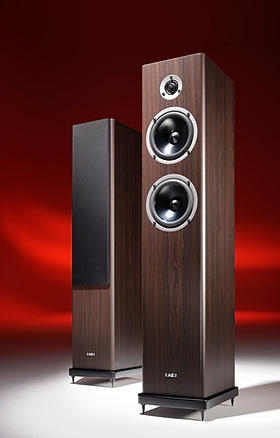

I have Acoustic Energy neo3 fronts and neo1 rears. Not sure how they fair against the tannoy but I think there an amazing sound. I've never seen a bad word about them.
I've got V1s which I got on close out, £175 for the fronts and £100 for the rears. The V2s Are now on close out on there bay site. http://m.ebay.co.uk/sch/acousticenergysales/m.html?_pgn=1&isRefine=true
Bummer, just wrote that and it looks like they have sold them, they keep popping up though so worth keeping an eye out. Think the fronts were £275 and rears £129
