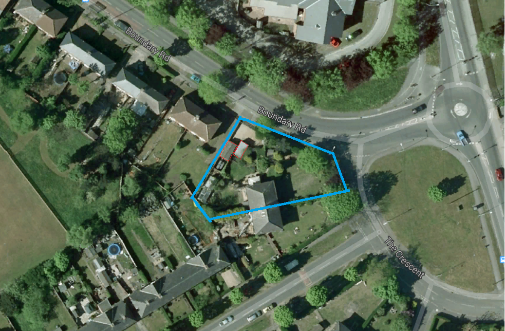

The address is * The Crescent but the gravel driveway and front door face Boundary Rd. I want to replace the two existing garages highlighted in red with a single structure which complies with the criteria for permitted development- But that's working on the principle elevation being the easterly side that faces The Crescent...

when its not immediately obvious they usually say it's the elevation with the front door on it, if you approach that way from the road too it adds weight to that being the principle elevation.

Your principal elevation is clearly the one facing the crescent and i'd be amazed if anyone could argue anything else.

I would say that since your property is semi detached your principle elevation is the same for both properties i.e the crescent regardless of where your front door actually is.

Looking at your neighbours (did a bit of stalking, know the area), as all the houses on "the crescent" face "the crescent" then that would be for me the principle elevation, also if you look at the house at the other side of the crescent (access on bowbridge road) they have built an extension where your front door would be, designed in such a way it would be classed as a side extension in appearance.
