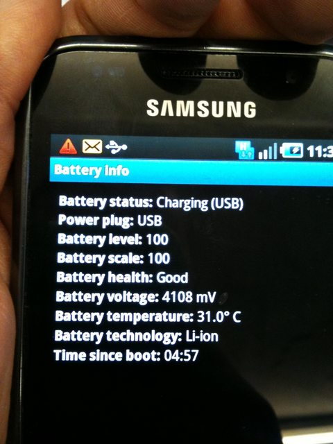

Also, I think I may have found something strange that could be the reason why it's crashing, it seems to think that a USB cable is connected when there is nothing connected to it. I'd like to post a screenshot but I haven't figured out how...

I feel stupid now as I couldn't figure out how to get a screenshot which is a pretty basic feature... :o So I had to resort to using another phone to take a photo of a phone! :D
Anyway, here you can see that the phone thinks it's charging even tho my hand is over the USB connector:
It won't even let me change the USB mode:
So I'm stuck in KIES mode right now which is a bit of a pain... :(

Could you do the following to help out? Goto the dialer ("phone app - must be the default one, not dialerOne or anything) and type in:
*#*#4636#*#*
A menu called testing will appear - goto battery information and take a screenshot and upload OR note down what the top 2 lines say and put it here.
*#*#4636#*#*
Sure, here we go, I took this a few minutes after unplugging the USB as I have to have a USB cable connected in order for the phone to boot:
I've also used some compressed air to blow any dust out of the connector, so I'm guessing it could be a charging circuit issue?
Back + home has always worked for my limited time on the SGS but it doesn't matter, same result achieved (goes in /sdcard/screenshots you're right). This handset is broken though, at a guess either the charge circuit is fubar or the USB socket. USB socket is more likely, they are rated to 10000 plugins or something but failure on them is still pretty high as it gets the most abuse. You'll need to sort out an RMA sorry :(
The USB does seem fubar, I've tried plugging up to a PC, and yesterday it came up as 'Samsung_Android', but today it just says 'unrecognised USB device'...
