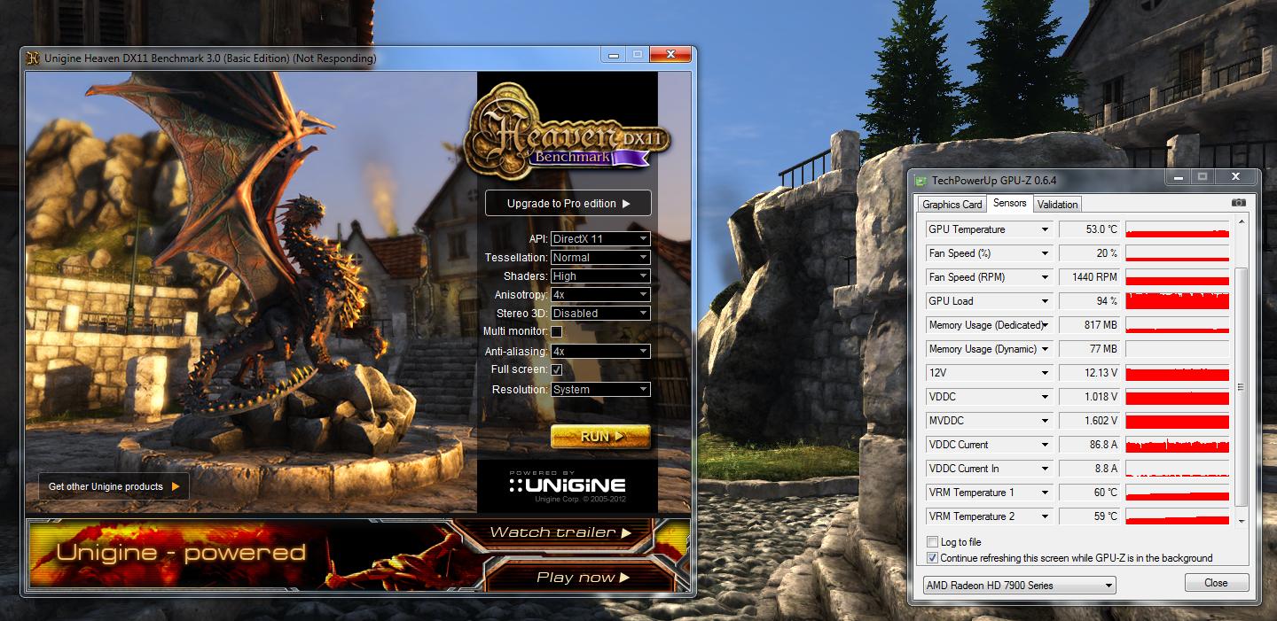

Not at all impressed with the fans that go with this cooler. they're 1200rpm and suck quite badly when the card goes full load. Temps could be kept under 45-50c but they rise to 55c and vrm and vram I don't feel much air flowing past the heatfins to cool them either. Think this cooler needs 1900rpm fans to properly cool everything on the card. vrms and vram temps are hitting 70c on heaven benchmark stock after a while, and that's just from slowly rising temps, as they start off at around 30-40c, just through lack of airflow the fans aren't giving.

At the time I picked them since the other options were 'due soon' and thought these should surely work but they're barely any better than stock, if not worse for keeping the vrm/vram cool. 70-80c on stock heaven runs. They keep the core nice and cool10-20c better than stock, but they just run so weak 1200rps barely breaks through the heatsink to get to the pcb at the back and cool the vrmvrams heatspreaders and they start to boil over.

Idle temps
after 20 mins
30 mins
Currently using the two fans from my 620 and now have better cooling results. Just pulled the push fan from my 620 because it was making a bloody racket, pull works though(is cooling the cpu)....bloody useless they are!
Also of notice was my vrm heatsink had fallen off so I was getting rather high temps because of that. Still a lot of tinkering to come I feel though :rolleyes:
