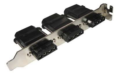

well i know what you are doing, as i have done this, i bought this....
only cost a few pounds, then all you need is a 3-1 molex for the insiade of the case, all very cheap ect of the bay

I see what your saying, I looked into a Cheap Power supply, just thought i could make the box smaller by just running a 12V wire into it. I wanted it so that i didnt have to have my PC on, but no you mention it and the more thought i put into it it becomes more sense to have that groovy Molex slot thing instead then just make a small mod for the switch. Cheers for the input, off to B&Q soon to get *** Wire i need to make the cathode reach. I'll post piccies :D
