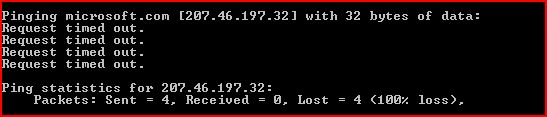

and heres what happened when i pinged microsoft.com?

And finally, the choice of Microsoft was not good. The request for Microsoft.com did get the MSFT IP address (207.46.197.32) from your DNS provider. But a microsoft computer at that address is (apparently) not responding to pings.
Try another computer such as your own ISP. Or maybe ping buckinghampalace.co.uk. A good internet connection should result in short response times - maybe tens of milliseconds.
You may or may not have discovered a weakness in your DSL line. Further investigation is suggested.
