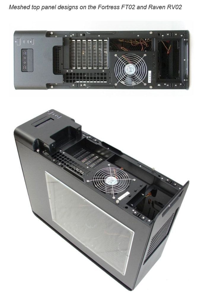

My case does blow the heat out the top...:):D;)
;)....Try googling for Silverstone FT02 ...;)
http://www.fudzilla.com/component/k2/19585-silverstone-fortress-ft02-chassis-gets-reviewed?showall=1

One of my cases is a Silverstone Raven 2 which I've had for quite a long time (8 years!), the 90 degree rotation of the motherboard has another advantage, no video card sag.
If memory serves, the 90 degree rotation used by Silverstone is patented .. which is why they are the only one with this design.
