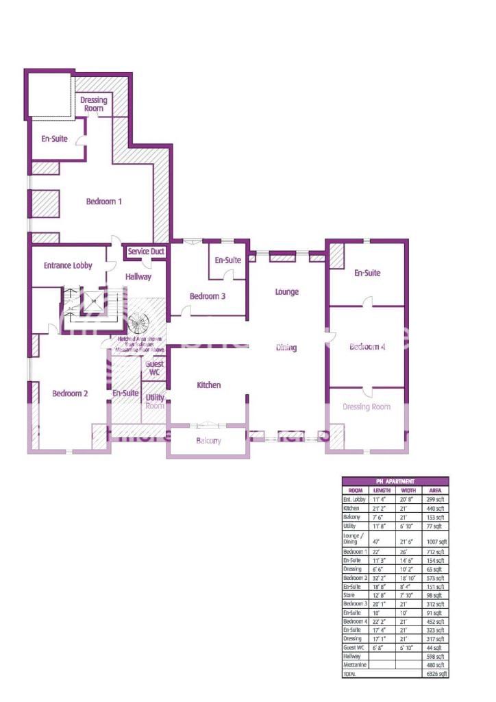

I am doing up my flat at the moment, its quite big and has solid walls.
I would like to get a good wifi signal in all the rooms so I thought it may be a good idea to put some sort of antenna system in.
here is the floor plan
http://i872.photobucket.com/albums/ab283/nastytooth/ph.jpg
I thought maybe one in the utility room and one in the dining room.
The walls not plastered yet so I can put in what ever cables I need, I have no idea about this stuff so any suggestions would be useful.

Get a good quality router, pit it as centrally as possible, test the signal take it from there.
Some seemingly solid Walls the will signal pass through as is it's not there, other thin Walls stop it dead in it's tracks.
I will give it a go but problem is that the none of the plasterboard is on yet nor are the sold walls plastered so when that is done the signal my change but it will be too late to put cables inside the walls.

I found in most situations a little over half way gave best strength for the range. However, in preference I'd run a cable and use them as access points; much more reliable. Other than you'll have to manually switch between the different points depending on strength if there is any overlap.
IMHO... get some CAT5e cable run out now whilst access is easy and if you need additional APs, you can cable them back to a switch / router. Saves messing with APs in repeater mode.

We do plan to run cat6 to every room.
