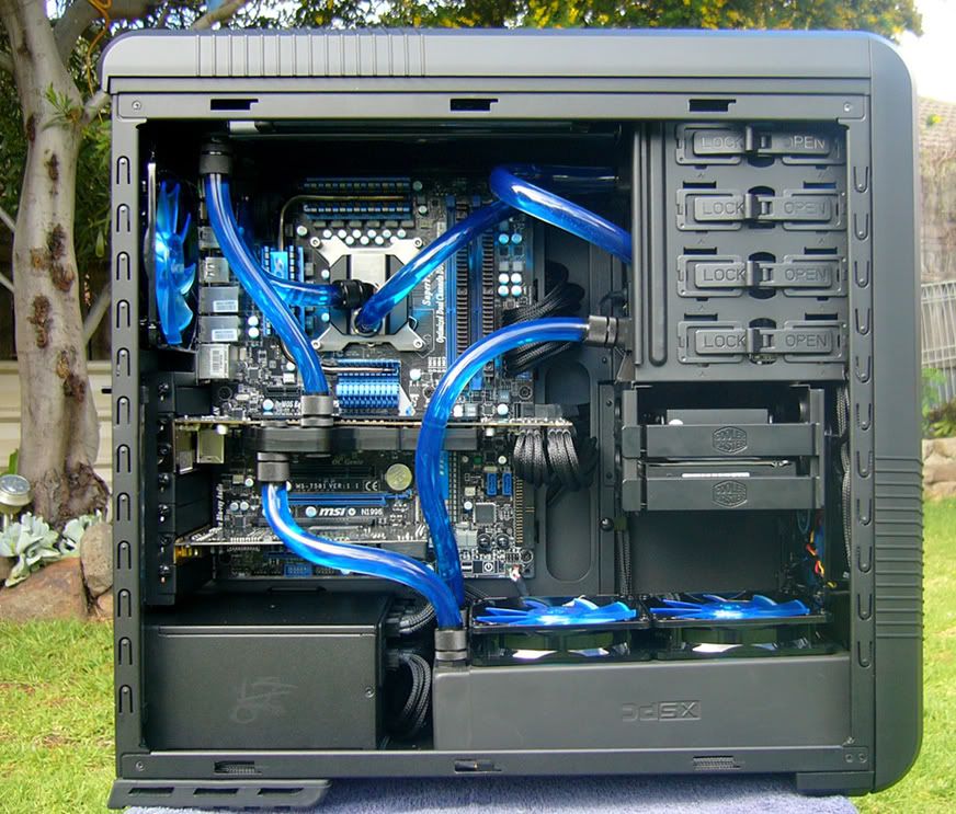

I've seen these systems that are good examples of what could be fitted.
The typical twin 240mm system. Probably the best option, but nowhere to put the pump/res. A bay res would be out as i will have used all the 5.25" bays to empty the bottom of the case to fit the rad. There might be space by a whisker on top of the psu by the sound card.

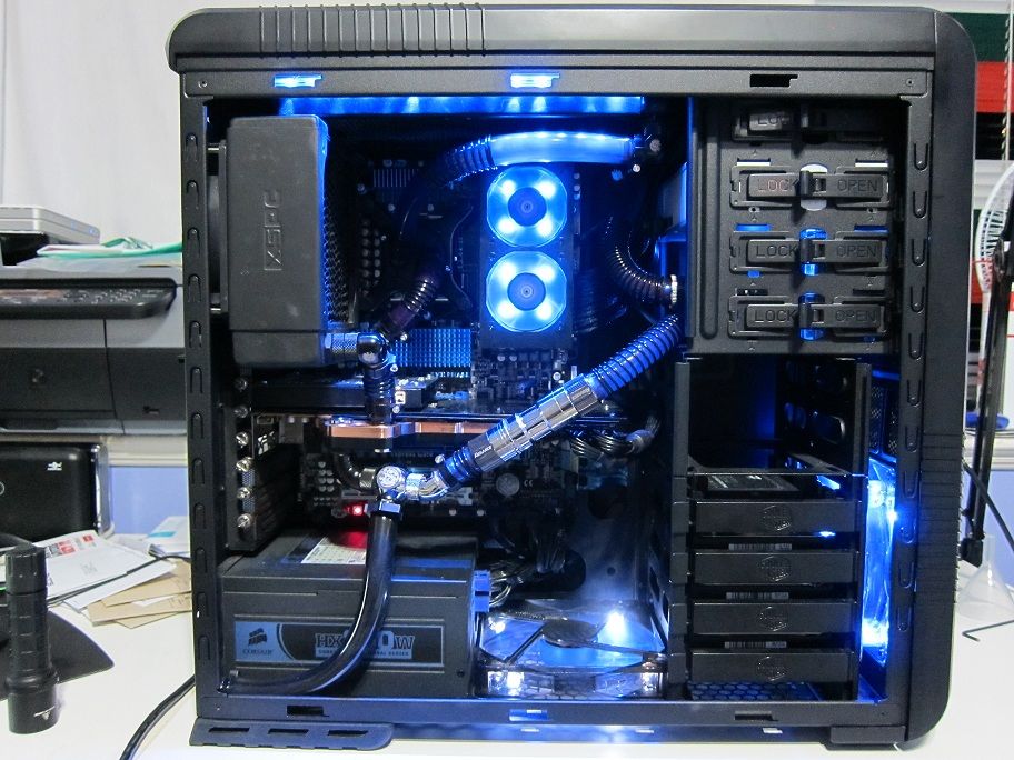

A thick 120 in the back with the ports at the bottom. Space around the cpu socket will end up quite tight, making tube routing a tad difficult. I imagine the cost in angle fittings might be a bit prohibitive.
A thinner 120 rad with the ports at the top. Probably close on impossible without finding the right angle fitting for the port closest to the mobo.
You've got case openings for tubing at the top rear, so why not mount the thick 120 outside with the ports at the top?
Those ports don't seem to line up with the radiator barbs. The ports are closer together than the barbs. (at least with an xspc rad) Would be a neat solution if there is a rad that has barbs in the right positions.

Whichever way I would be going, the radiator would have fans blowing air out of the case. The intakes are the front fan and 2 fans in the side. The back and the 2 top fans exhaust.
Presuming they're all the same size, you're going to end up with negative relative pressure in the case which isn't ideal - your rad fans will have to work harder and you'll also hoover up dust into the case.
2x 120mm & 1x 140mm intake & 3x 120mm exhaust at the moment. (will be changing one of the 120mm intake fans for a 140mm at some point)
I keep the case free of dust by cleaning it out once a month.
