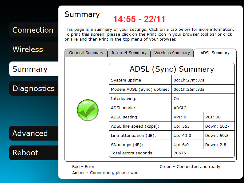

First, here are the router stats as at few moments ago.
The problem I am experiencing is that after 2 years of a relatively stable connection at around 1.1MB delivering a real .9MB to 1.1Mb, in recent weeks the connection has started to play up. The router is often re-syncing between .3MB to 1.1MB with an SN of between 2 and 10 - mostly around .5/.6MB at an SN of 6.
When the resync level reaches over .9mb (which is not as frequent as the lower figures) the actual speed I get is around .3MB, possibly because the SN drops below 6.
I have had 2 visits from Openreach who confirm that the line from the house back to the exchange is 'excellent' for it's length and I have tried 5 different routers as well as having a new connection box fitted on the line.
There is no other extensions/equipment connected to the box other than a cordless phone.
The ISP (TalkTalk) also arranged a 'lift and shift' at the exchange to move my connection to a different port on their exchange equipment.
After 2 years of a stable service at around 1.1mb, and there being no changes in equipment from the exchange to the modem, I cannot figure out (nor can TalkTalk) what has happened.
Whilst TalkTalk try to figure out the problem, I had read that their D-Link routers are cheap and nasty and that a better router could help with stability (and possibly increase speed marginally).
So my questions to the gurus here are:
- Would a better router possibly help (one that can handle high attenuation and low SN for example), and if so what would you recommend,
and
- Has anyone any thoughts about the issues/stats above?
