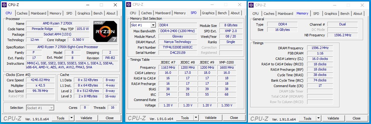

In my experience samsung b-die or nanya a-die just work. I bought a rgb 3200 nanya kit from china for £35 and paired it with a 2700x and it literally went straight in on docp on my super cheap b450 asrock.
It was actually easier to set up than the 64gb of b-die im using with my threadripper rig. Weirdly the nanya a die can even be set at 3466 without any issues at all on boot.

for £35 for 16gb of RGB you take what you get, I was super surprised just how good this nanya a-die is. Overclocks very well indeed and stock I didn't need to touch anything at all I ended up buying a few kits and gave one to my buddy, same deal straight in at the correct speeds on his 2700x that he was also building for his wife:
This is on a board i paid £42 for (b450m-hdv) im actually running it 3200 c14 at the moment in the mrs machine.
