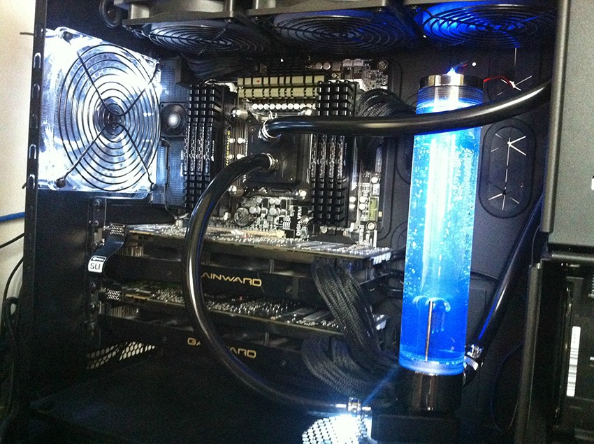

OK all done !
Ive had a productive day "working from home" today ;) and swapped out my CPU block with an EK Supreme HF (bought from the MM):
and installed the new loop and Phobya 150 Balancer Res :
The Blue LED in the res is just a temporary one until the white one arrives :D
