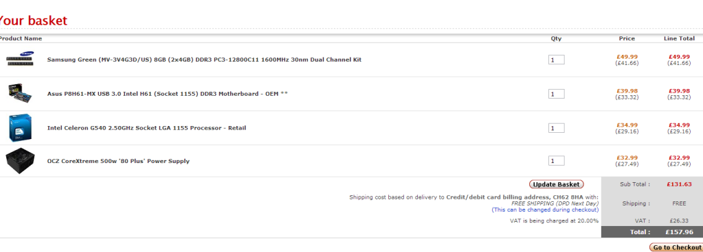

Hi Guys
Having not built a Pc since C2Q6600 would you mind taking a butchers at this little lot and tell me if it will be fine ... not decided which case to go for yet .. low power and silence is appealing .. its just going to be used for general office use.
It won`t be getting clocked thanks
For general office use that will be fine. 8Gb of RAM is a little of an overkill though if you wont be doing anything intensive, which I doubt you will due to the CPU. 4Gb will easily suffice.
No need to spend that much on RAM when any old stuff will do. Cheapest 8GB DDR3 would be my reccomendation.
Also ask in CS what the OEM mobo comes with. Other than a reduced warranty ofc.
Thanks appreciate it,I was thinking of a smaller power supply but there is not much difference in the price besides i like the specks as I want to protect my hard ware should anything go wrong , Is a 500watt regarded as better or should I get a smaller 350watt which would probably be suitable and maybe more economical not to mention cooler if am correct
Do you need this now or can you wait for the mobo, as i said, ram is on offer today only.
The mobo would probably be sent once it is in stock.
