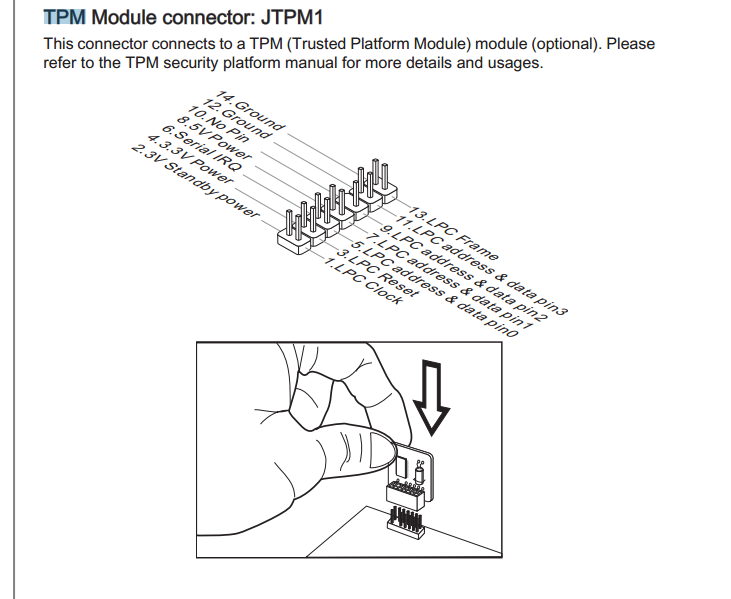

You have a TPM header on your board.. If you look at your motherboard at the bottom right you have your 3 power buttons... To the left of that is a com port and to the left of that is the TPM header...
You could buy a TPM module off the net and simply install it they are around $15:)
TPM pinout of your board so you can check if one is compatible :P

i have an asus z97 and its not built in. Just a header like yours..
Your other option would be to just leave a USB flash drive plugged in the back :P
