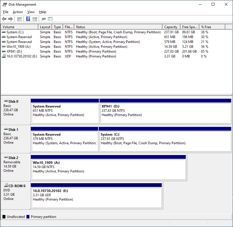

Installed Windows 10 onto the 850 and then cloned both partition over to the XP941.

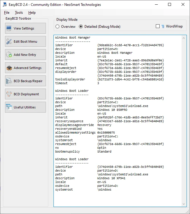

Used EasyBCD 2.4 to add in an option to boot from the XP941.
Doesn't work: selecting the XP941 boot from the Win10 boot loader results, after a timeout, with a generic 'please insert valid boot disk' type message.

So at this point of dickery, I decided not to persue the UEFI option (which would have been the cleanest). So I installed Windows on the 850PRO with the intention of cloning it back to the XP941 and using some kind of boot manager to get Win to boot from it.
Clonezilla laughed at me. Complained about mismatch GPT/MBR stuff, even though both drives were set to MBR (doubt checked and even zapped the XP941 to be sure).
Tried some random tool called ToDo Backup, but only in partition clone mode as the "system clone" function requires monies/registration, so f that for now. This did clone the partitions and I used EasyBCD 2.4 to add in another boot option for the XP941. Looked good, but no, will it boot? Will it ****. Get some error that the main boot file is not accessible/available/missing (\Windows\system32\winload.exe).
