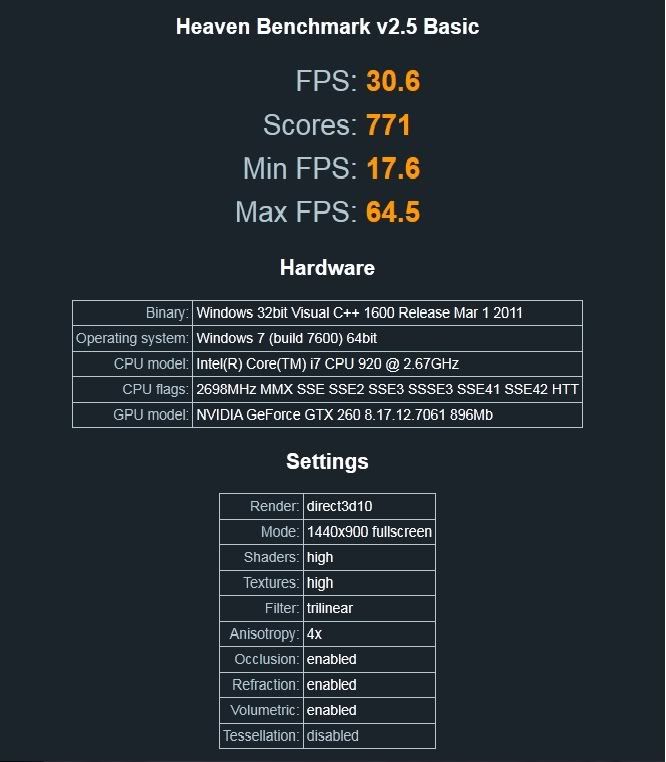

My results from heaven benchmark - at the risk of sounding a noob, does this mean my GX card is fine?
Also (as above), my binary is 32bit - is that right? :s

As for GPU, the benchmark shows that it's ok but you can use the Folding @ Home GPU client to test stability and temps on full load.. but i would check the PSU first anyway.
