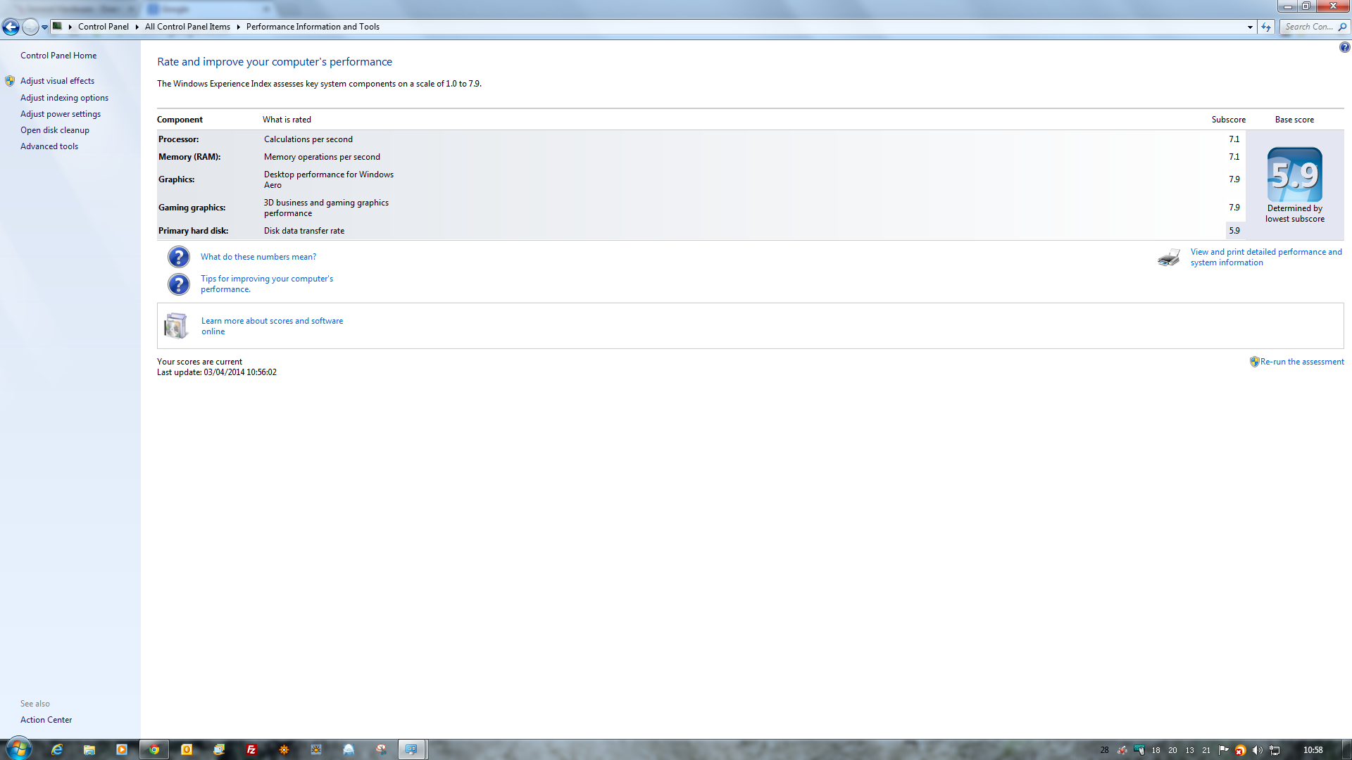

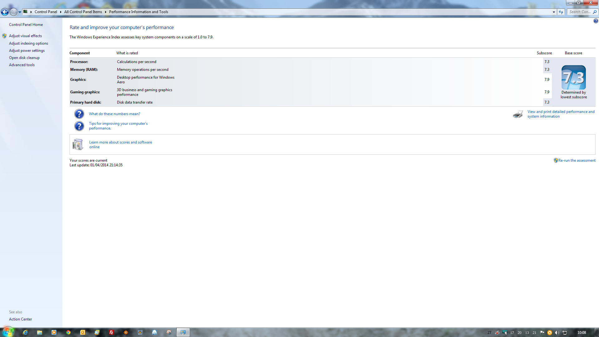

I ran a Windows Experience Index test update and was surprised (and annoyed) to see that with the new RAM fitted it had not only decreased my score in 'Memory Operations per Second' from 7.3 to 7.1 but for some unknown reason my 'Disk Data Transfer Rate' has dropped from 7.3 to 5.9? :eek:
What's going on there? I would have thought that doubling my memory in the system would have improved performance, not reduced it?
I iz confuzzled. :confused: Images below.
With 4x1Gb = 4Gb Geil ULL RAM
With 4x2Gb = 8Gb Corsair XMS2 RAM

Yep, but I ran a WEI on the Tuesday 1st April (first image above) and it gave me the 7.3. Then after I switched RAM over this morning I ran the WEI you can see in the second image and it shows 5.9. While I can understand drive performance dropping off over time, surely it wouldn't drop in the space of a couple of days?!!
