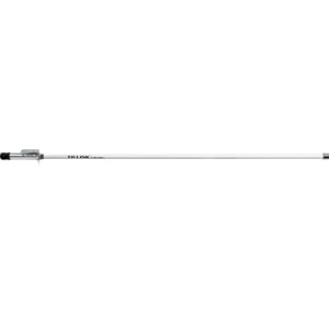

Should I invest in a TP-Link 15dbi omni directional antenna (TL-ANT2415D)?
http://ecx.images-amazon.com/images/I/215m6xiXnPL._SL500_AA300_.jpg
I'm open to suggestions, low cost is preferred of course
