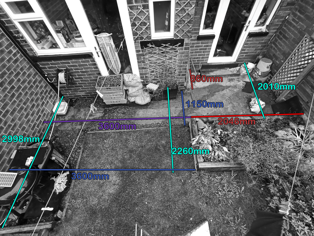

looking to lay some paving in the back garden, but having issues working out how many square meters of paving I should order.
the pic's are taken from 2 different angles
anyone good at working this stuff out ?
Remember to add a good % for the cuts and also my supplier indicated to add 5% for their breakage in transport (!!)

Also just do as above, measure the whole area, and deduct the left corner from the total.
I would also say, what program did you use to show those slabs, because their are some strange size slabs in that design.
Whats the total length and width?

The planter is killing the useable space. And so is the curve if the grill is staying where it is. You will end up with a setting area of 2.4x2.2m Then factor in the kitchen door. Square the paving across from nextdoors extension. Get a line marking can of paint to mark your ideas out. It will help you visualise the space. Where are any table and chairs are going, the space the grill needs, the impact of the doors on where you place a dining set etc. Remember to allow for people using these things (chairs out from the table, 600mm extra for someone work the grill).
