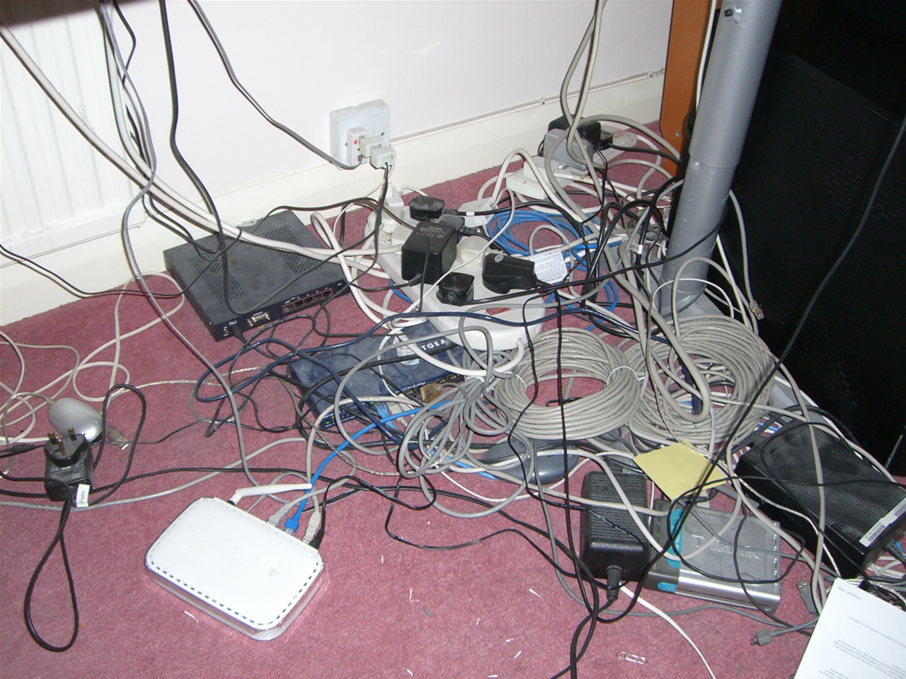

Would this mess cause problems?
5 Feb 2003
365
I have attached a pic of what is beneath my desk. Would this pile of cables adversely affect my internet signal? The router plugs straight into the adsl socket on the wall. The pc's are connected by ethernet cable.
Thanks,
Jon
I would say it would.
Might not effect any wireless signals but is more than likely to effect your ADSL sync rate.
We had a power cable cross over our phone extension lead and that really messed up the ADSL
All that dust won't be good for the kit either lol
Get it tidied ;)
Aaron
