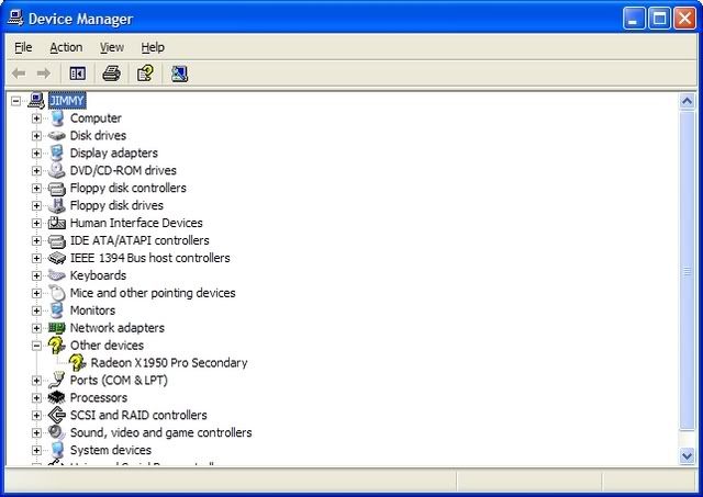

Strange looks like my pc thinks it has x2 graphics cards :S
