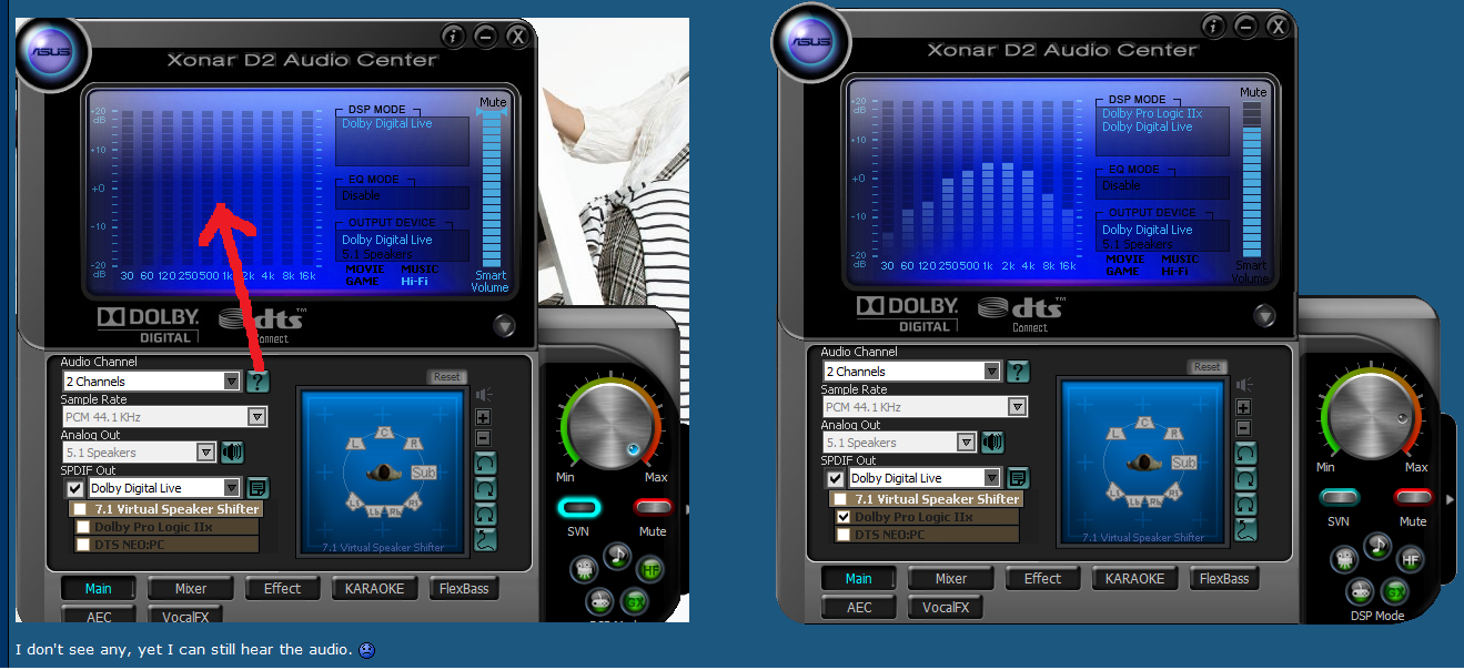

Everything in the audio centre seems to work fine when using DD or DTS. Recently gone from xp 32bit to W7 64bit, the problem is the same. I've enabled the mic monitoring, not sure if it has worked or not yet, although i do get a loud hiss if i turn SVM on with it enabled (used to occasionally get it when mic monitoring was disabled).
Definitely still works, any changes i make in the audio centre have immediate effect. What drivers are you using? I downloaded the latest for windows 7 but the ones on the disk worked fine in xp, i even updated in xp to try and fix the problem i'm having and the settings in the CC still worked.

On xp i removed the xfi drivers, turned off pc, removed xfi, turned on and used driver sweeper, turned off and installed the xonar and then drivers. i used the analogue connectors at first, then i used the toslink cable supplied in the box and it worked straight away. On W7 i just left it connected as it was and the control centre continued to work as it had done before, although the problem remained.
