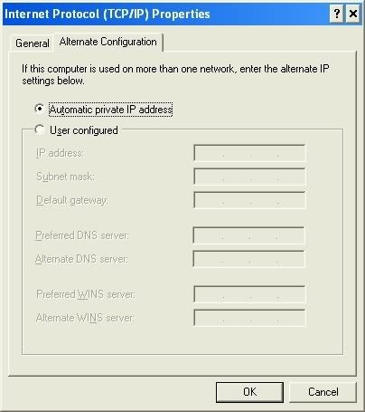

Since looking at the TCP-IP screen again I noticed there is an "Alternative Connection" tab.
So it should be feasible to support both networks by the onboard LAN? When Windows is logged out of account associated with instrument and logged into a different account to connect to company network?

Will get to play around with it later, so hoping the Alternative Configurtion tab I posted previously will work.

The Alternate Configuration tab (see post 4) has resolved issue when disconnect instrument from local PC, and connect PC to network. So no longer have to alter TCP-IP settings since I putt the instrument requirements in the alternate tab.
