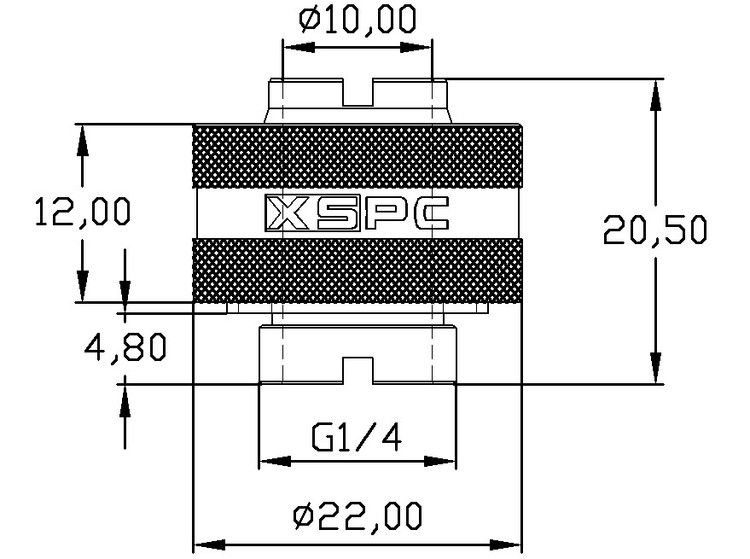

I will try to get a couple of pics tonight, obviously the burrs are no longer there but you should be able to see where I filed them off, I did find this pic on the XSPC site showing the profile of the fitting
You can see there where the thread has a slot cut into it
