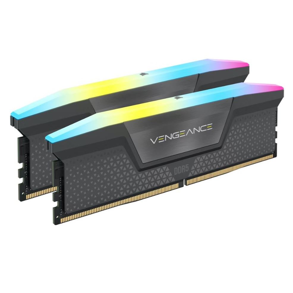

The ram you have chosen is expensive and pointless for ryzen. 6000mhz is the sweet spot and I dont think many chips will go above that speed anyway.

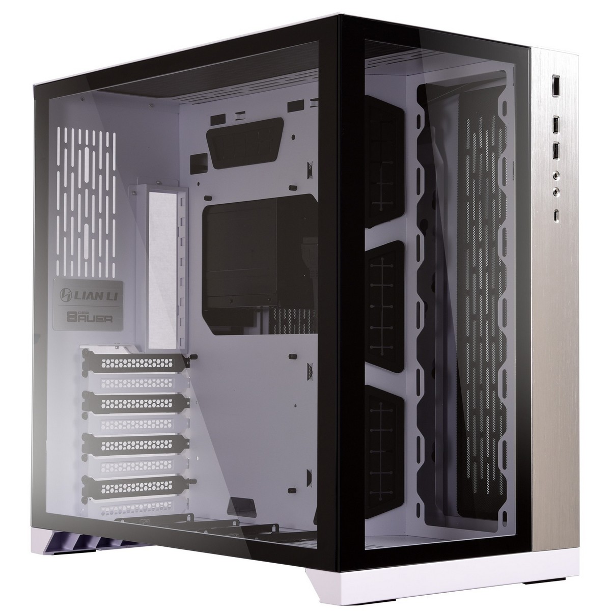

Case: seems kind of similar aesthetics, but this one includes 3x120mm fans and I don't think the Lian Li includes any?

RAM: 64GB for the same price and the X3D is not very sensitive to speed. If your editing doesn't use it then a bit of a waste, but at least you wouldn't need to upgrade any time soon.
