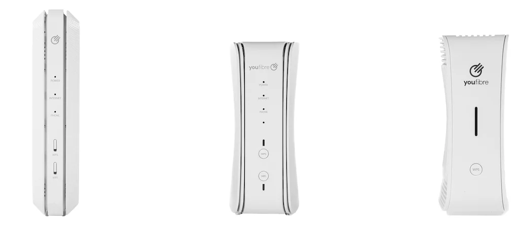

I noticed this over on the YouFibre reddit and thought I'd repost it here. It looks like YouFibre are going to be rolling out new YouFibre WiFi 7 routers and YouMesh WiFi 7 Boosters to new customers going forward.
YouFibre Hub (FAST 5598 YF) - User Guide
YouFibre Hub Pro (FAST5599 YOUFIBRE) - User Guide
YouMesh Booster (FAST 281 YOUFIBRE) - User Guide
https://www.youfibre.com/setup/
They're all rebadged Sagemcom units.
Does anyone know where I can find a technical spec of their new routers, they dont seem to be able to supply one (have tried multiple request to them!)
