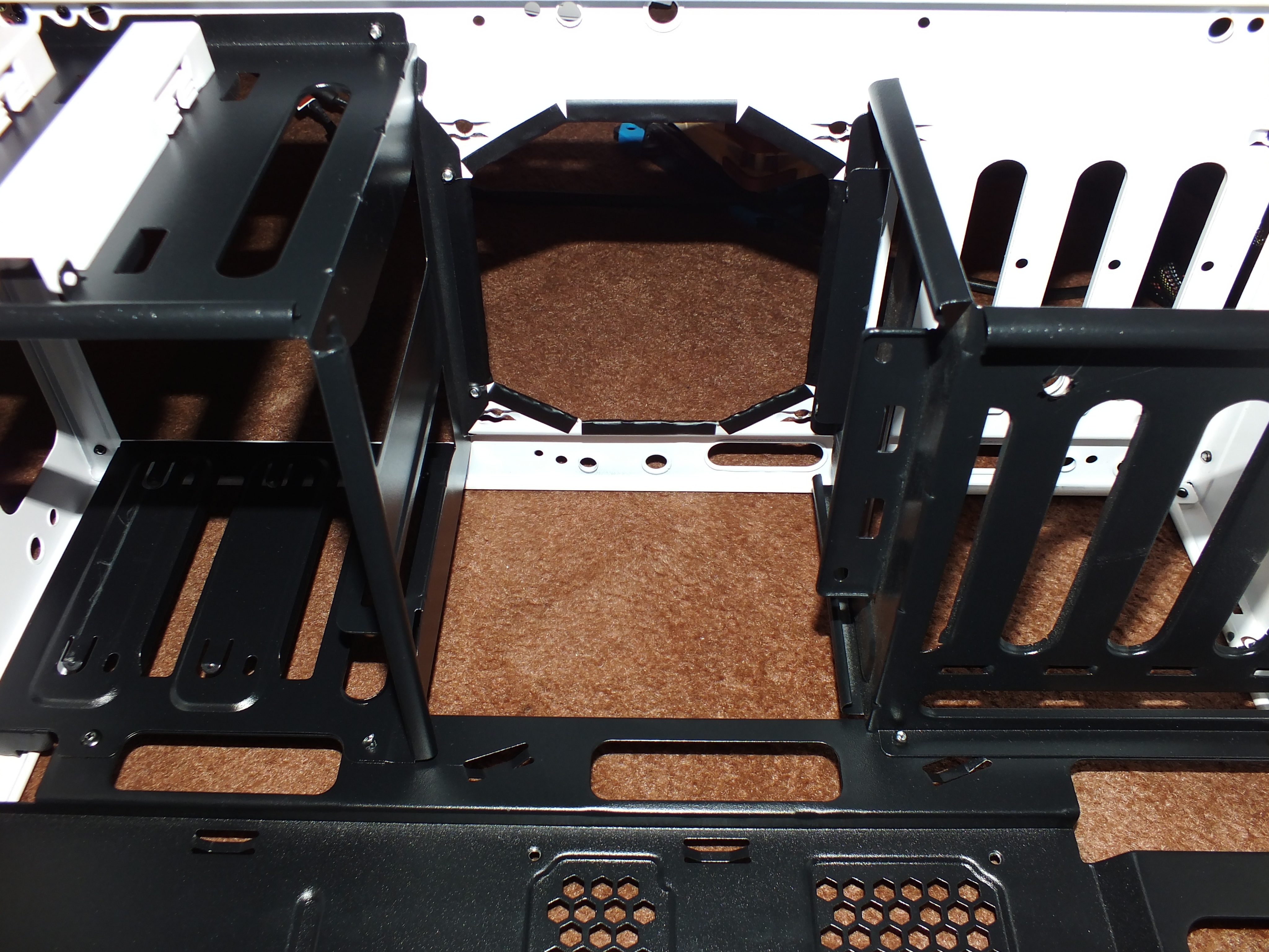

The most difficult part is re-drilling the holes on the front. I was using ø3mm, ø4mm, then finally ø4.5mm drill bits to prevent damages - here's why:
As you see the holes have only a bit smaller dimension from width of Fan mount brackets. Now you noticed I was also remove the mesh from top Fan on the front. We'll come back to this in the minute

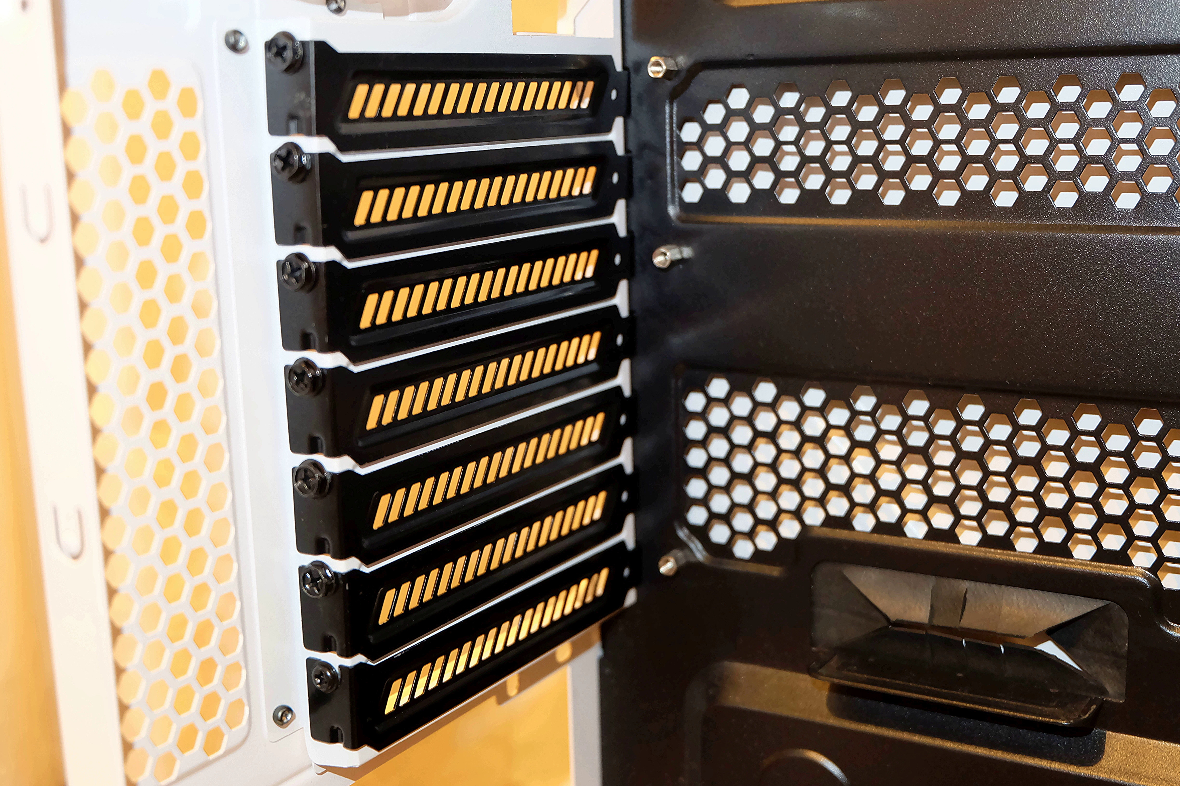

And finally last thing - must have! All cheap look PCI Slots been replaced with proper black ones which gives much better look:

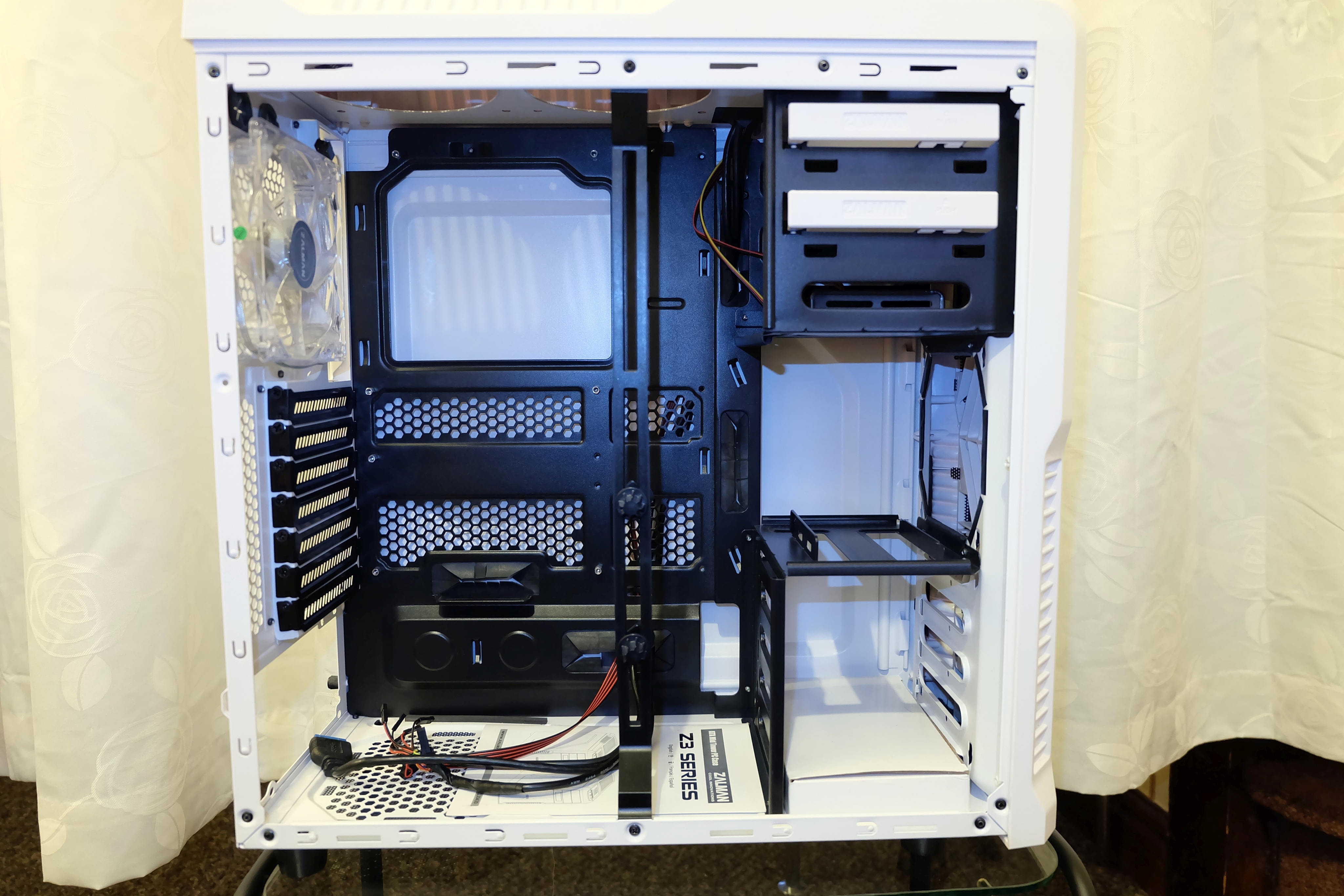

And after all this jobs my PC was look inside like here:
