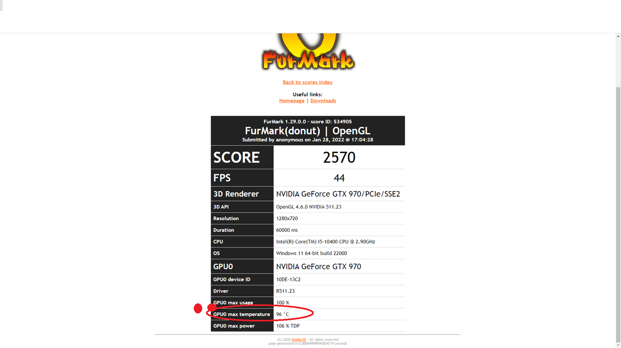

having issues with above all is fine but i have no fan spin and it crashes everytime i try a benchmark, temps rocket to high 90's
any ideas
