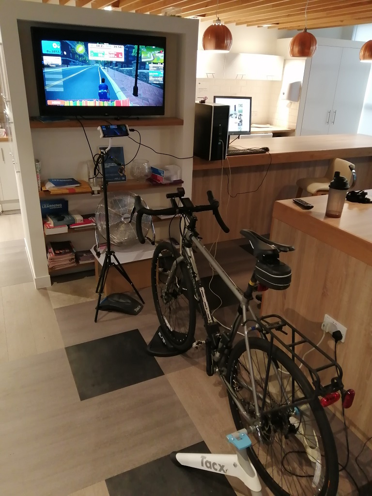

My crazy pandemic setup is below while I was locked in a big open office for 18 months tending the server room!
Poco X3 phone connected to the LG TV via a HDMI cable ran Zwift with no issue.

May have to give this a try tomorrow. How much sensor input did you manage? Any apps help to optimize the connection? Thinking more of ANT+ in particular...
Only app was Zwift. Connections were all Bluetooth as I had to buy anther heart monitor with BT.
Inputs were Speed, Cadence, Power (Tacx) + Heartrate (Lifeline strap)
