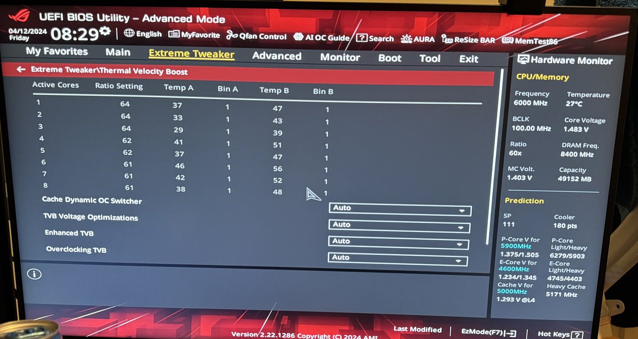

That’s how auto looks on my white apex. Not sure if/why it’s different on the encore.
Intel XTU on desktop to change/ disable the temperature thresholds.

Pretty certain that mine has everything on Auto as your picture shows, but mine shows whatever current clocks are on the left but nothing in the Temp or Bin columns.

Those are some high clock speeds you have in TVB! Is that showing before or after TVB? I am guessing after.
From researching, I presumed you had to use the 'Overclocking TVB' tab and select +1 or +2 or custom settings from there? You are saying it does all this for you with no other input? As that sounds amazing! Unless it gives stupid voltage.
Perhaps I need to select another option in the BIOS to properly enable TVB?

Just had another look at this screenshot! 1.483V using AI OC I imagine? Or is it stock?
Results look probably amazing, but that's a lot of voltage! Even if it is adaptive voltage, I am trying to get max core clocks and gaming performance with the least amount of voltage.
