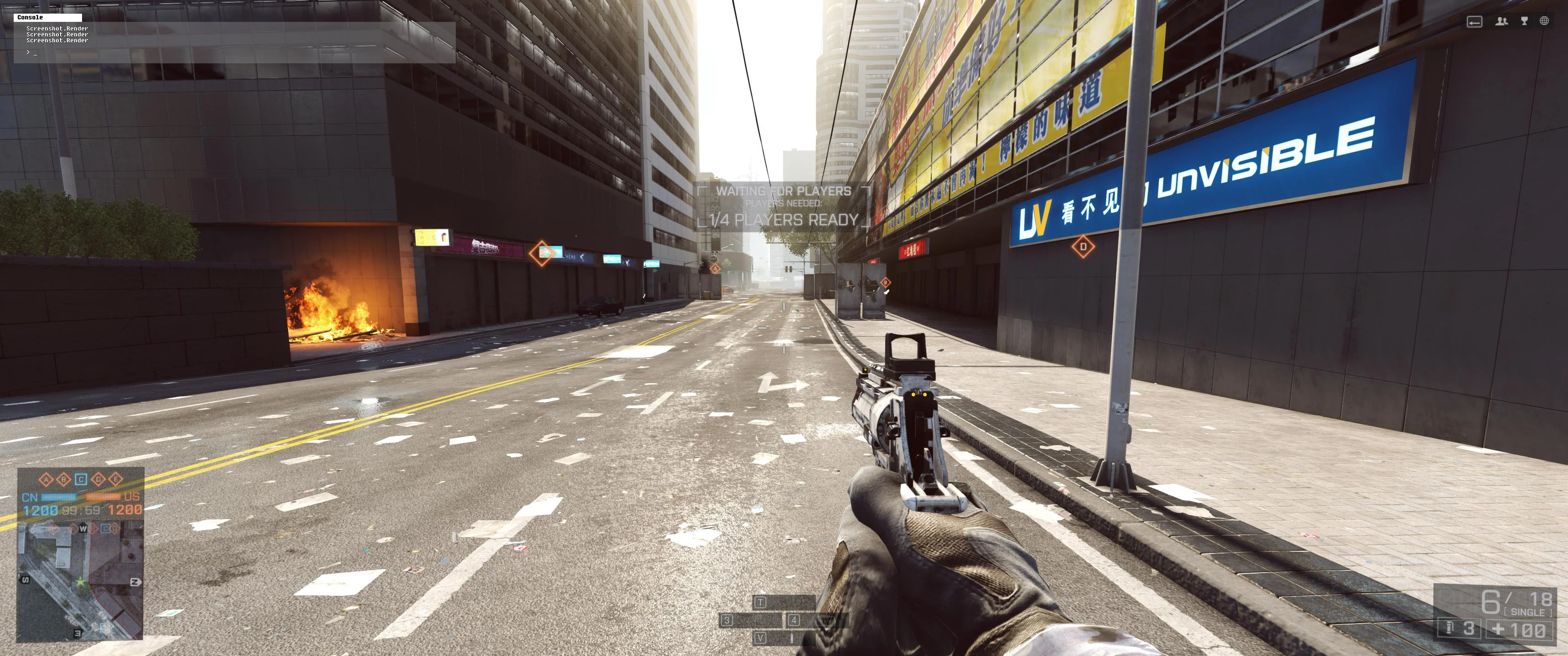

Here is the image with the Nivida control panel set to Display max quality:
Here is the image that greg posted with all option at default in the nvidia control panel.
It is something in the drivers.
