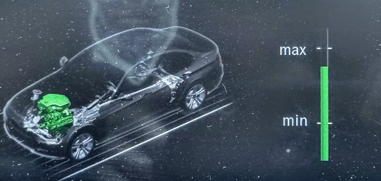

F series 330D, oil consumption after 3000 miles, seen loads of talk about it on BMW forums.
Not sure how much that might be, topped it up, but haven't checked yet. 2nd time this has happened, only difference is, I switched from Shell oil to Millers, same grading and viscosity. I don't see any leaks under the rocker cover (apparently the seal likes to fail round the back? Mines dry) and had a quick look around the engine without the cover to see, if there are any signs of oil. But its all dry... Next will check the intake pipe for oil residue, some should be ok, but puddles will indicate seal failure?
I service it around 5k miles, the leftovers from last service (roughly 500mil) easily last till then. Car is on just under 100k miles. Anyone having similar issue, or experienced oil consumption? It's not alarmingly high, I've seen one post stating the the owner had to top-up 1l every 1000 miles. lol

I bought my old F30 330d at 105k miles and ran it to around 140k miles. Lots of varied driving including some autobahn blasts across germany where I was sticking to 8th gear 3000rpm (about 130mph?) for extended periods. Never used a drop of oil in that time, I was changing it around roughly 8-10k miles at the time.
I remember it was meant to take 6.5L and I was essentially doing another 1 / 2 changes in between the dealer services myself. I was basically putting in 6L only and it would land bang in the middle of the dipstick, then it would remain at the same level for all the time until I changed it again.
It did help that it was 3.5 years old when I bought it and that it lived on a motorway all its life...
My M57 engined cars (330d and 335d) were both the same - not a drop of oil used even though they were at 100k miles plus, all 3 with a map as well. The e46 330ci on the other hand... easily over 1L per 1k miles, used to keep 5L castrol receipients under the bonnet with an extra 1L bottle for easier measuring. :D

We bought ours when it was around 3.5 years old too, 2nd owner, servicing was done around 10k at the beginning, but when we started doing euro trips etc, I started doing oil changes every 4-5k. Car was built in Jan 2015, pre-lci early model. What year was yours?
Edit:
Did a bit more digging, PCV and breather pipe are common, I already did the breather pipe last week as it literally disintegrated in my hands... I'll order the PCV repair kit and see what happens.
Edit:
Mine was 2012 / 62 plate, one of the earliest models. PCV is definately worth looking into at this age!
