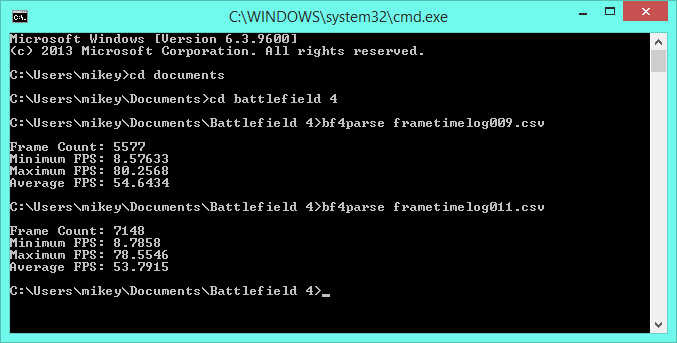

Just done a couple runs comparing dx11/mantle with a single 7970 and i5 2500k @ 4.8. Pretty much exactly the same as each other.
frametimelog009 is DX11 and 011 is Mantle :)
I'm not entirely sure where those minimums are coming from, at no point am I feeling the game drop frames that much.
Hi,
Not to throw a spanner in & after a few of my school boy errors i need to watch the wrath of LtMatt...however I need to ask, did you change the API then quit the game then boot back in before testing the new API?
The reason i ask, if you look at the mantle results there are always way more frames than the DX runs (about 10,000 +) with DX there are always around 7000, which both your results have?

Yeah, i'm 100% sure I did. But now you've made me doubt myself.
Ha ><. I'll retest if you think I really should.
edit. Just done another quick go, trying to follow as closely as I did with the last run and frames were almost identical. Who knows eh.
