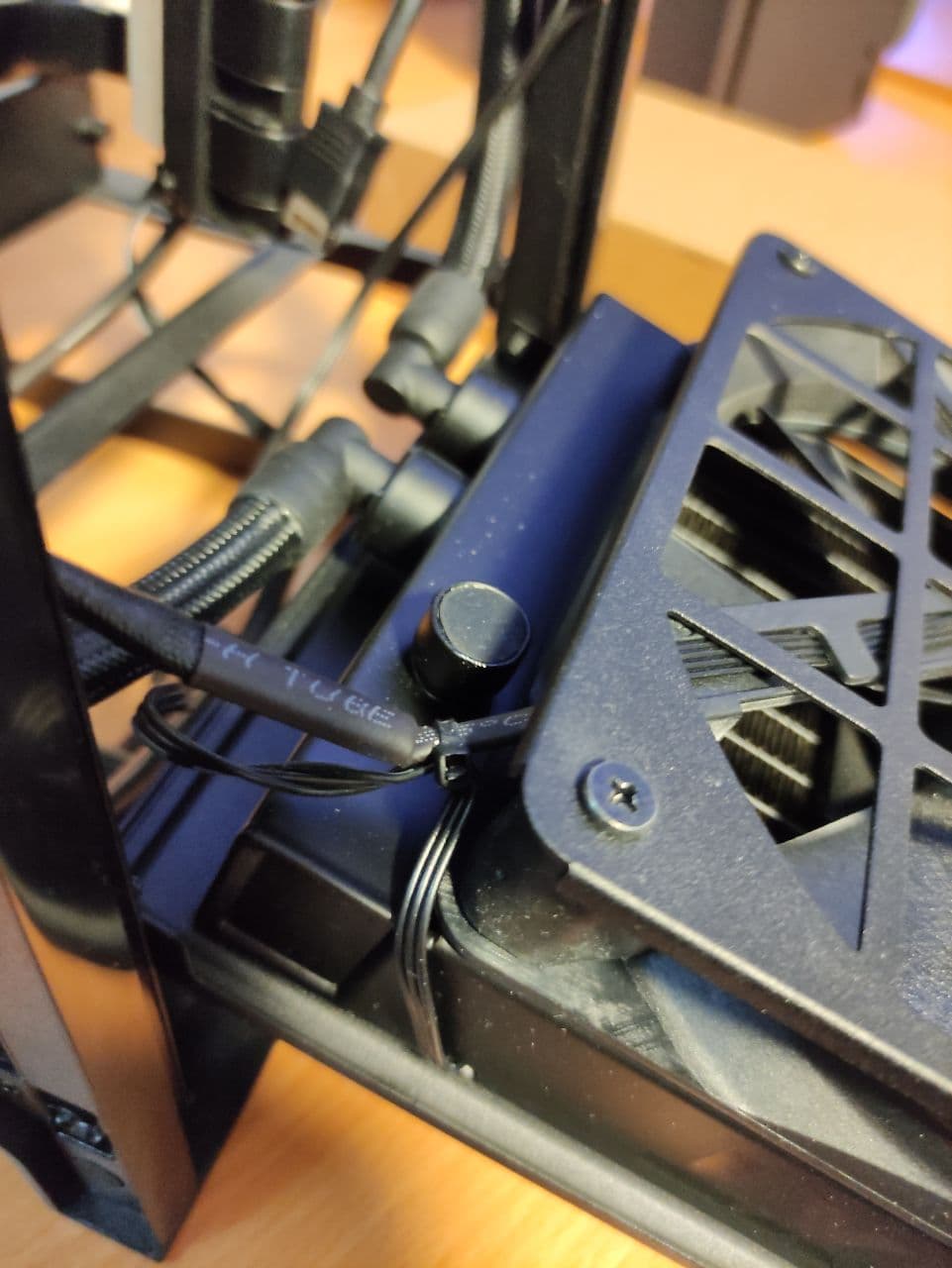

Managed to replace the NZXT fan on the AIO to the Noctua NF - A14 140mm. I've kept the rubber vibration pads in and was also suprised to find the fan cage fitted quite easily over the top. The 3 x 40mm Fans arrive tomorrow and I'll also be moving my whole build to this case, from a Dan A4. I'll update as I go :)
The AIO & Fan were plasticuffed very tight - had to carefully use a nail clippers to separate. See pics:
