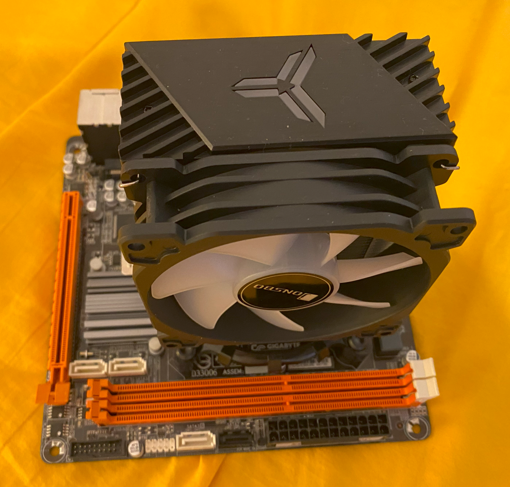

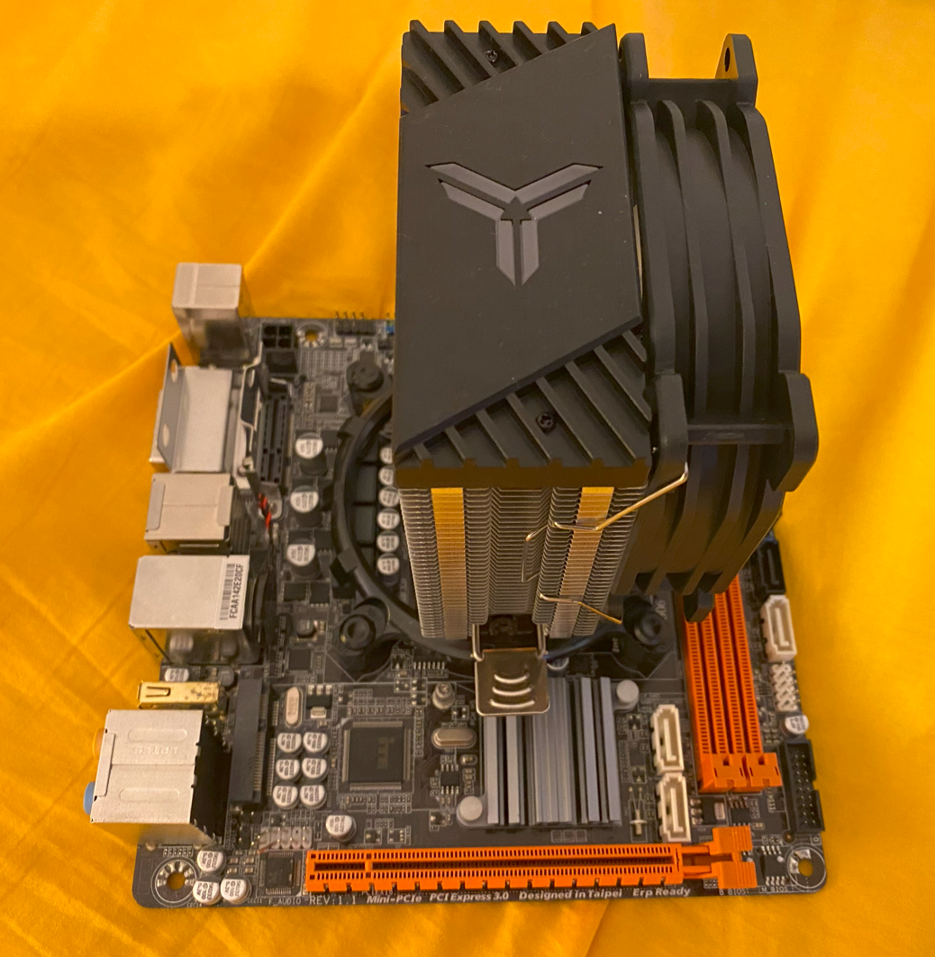

OK not done sod all because human malware. Did a little today, though.
Fitted the cooler and replaced the broken RAM latches with ones taken from an old board I found.
So the only thing wrong with it now is the single missing (it snapped off) USB3 header pin. Doesn't matter, not using it any way.
I also began the wiring. I got a bit annoyed at this, as it seems the Cooler Master PSU this was made for has a ton of double wires on the 24 pin. I started tossing them to one side, moaning and mumbling. And then I realised the entire 8 and 6 pin uses 6 double wires. Gosh, I shouldn't have complained lol. I just stole 6 single ones from a 6 pin to replace them with.
So we now have.... One 24 pin that will work on the ITX PSU, one 8 pin into 6+8 pin PCIE for the GPU and one 8 pin EPS. That only leaves one SATA run to be done and a Molex run. That was almost too easy......

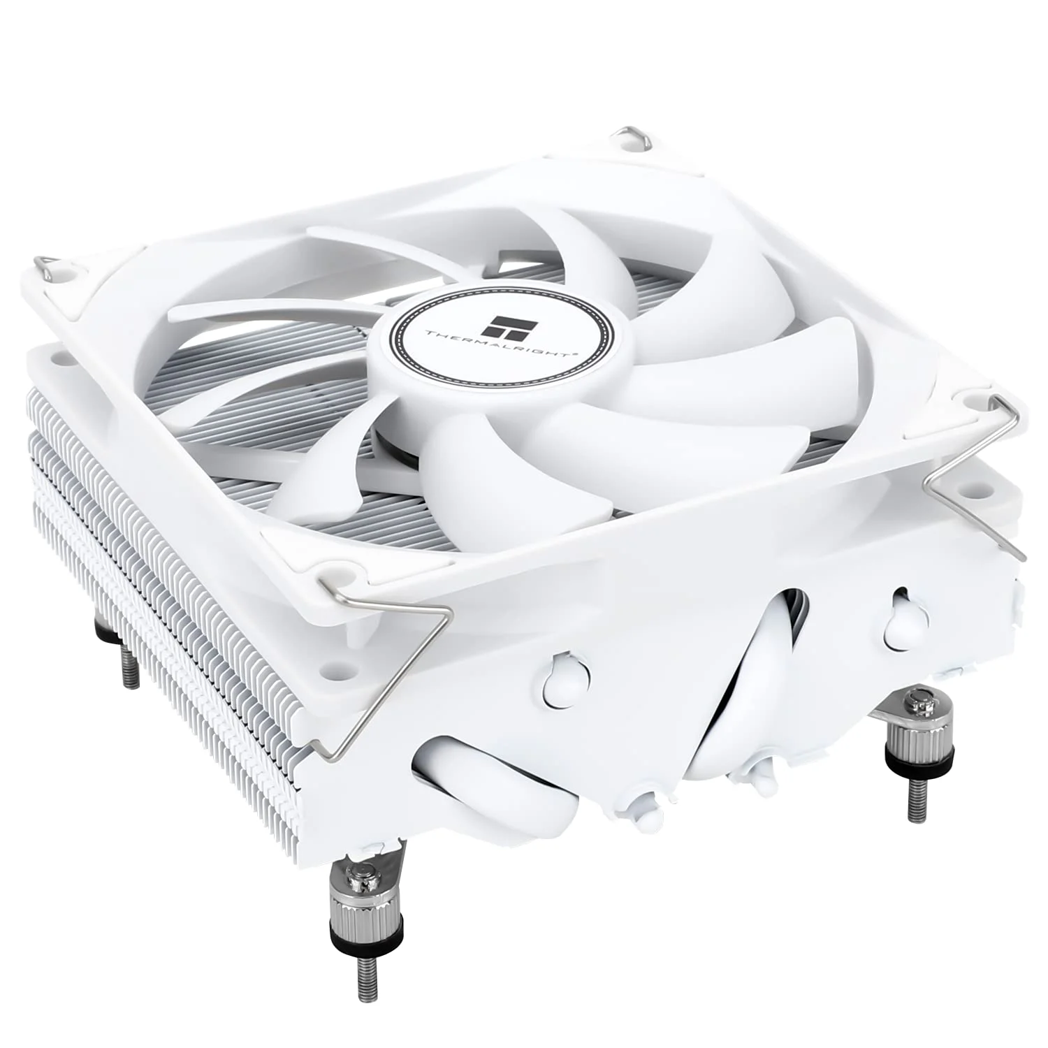

Sooo... First thing I did was dig my Q58 out of the loft.
It has been emptied since then obs. But, it is a modern ITX case and thus it is way easier to build in. I will paint it in the same way, but for now I just want it built. Just one problem, the cooler I bought for a tenner won't work. Thing is? this one will look way better any way.

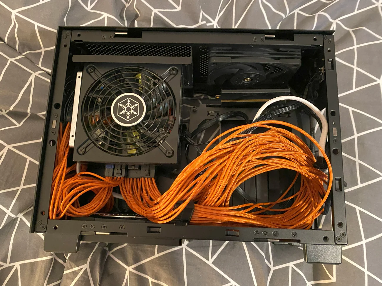

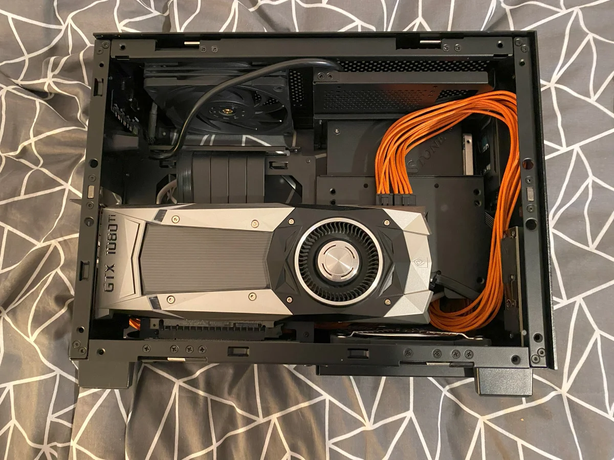

Update.
So I finished the cabling. IE the SATA runs and Molex. The Molex isn't needed, maybe never, but I did it any way. At least this way the PSU has its original full set of cables. I then fitted the PSU. Note - there are no cable ties, and I have given 0 Fs to wiring as it all needs to come out. I did manage to cram two SSDs in though, so plenty of storage !
Fitted the GPU. No cuts and no bending the case to get it in either. Remember, she's in drag. She's really a 980Ti lol

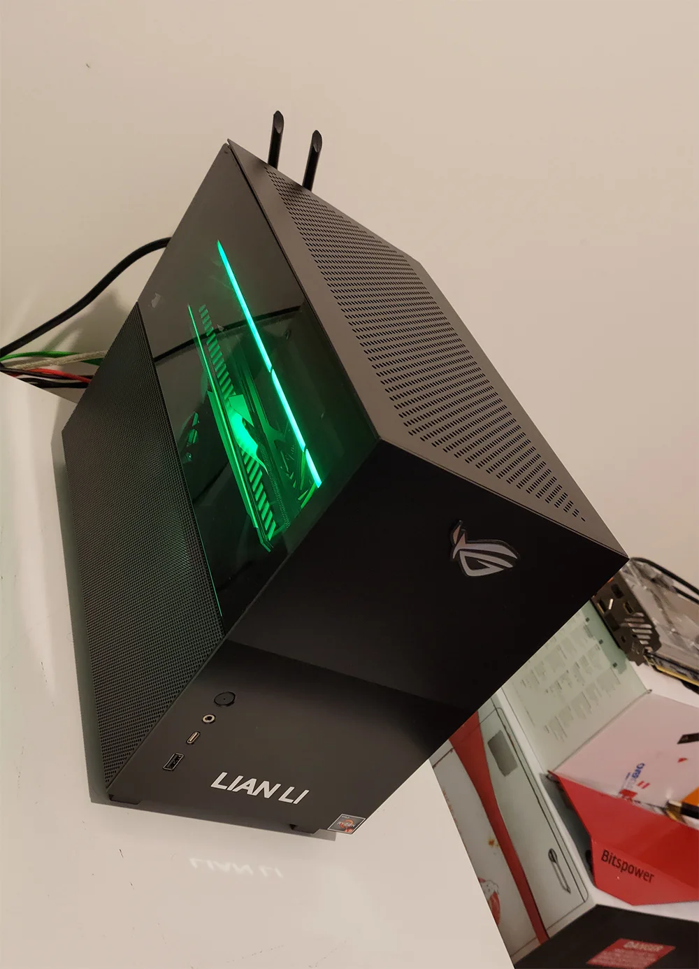

I then created a hacked Win 11 installer using Rufus, disabled TPM and all that rubbish and installed 10. This all went very well.

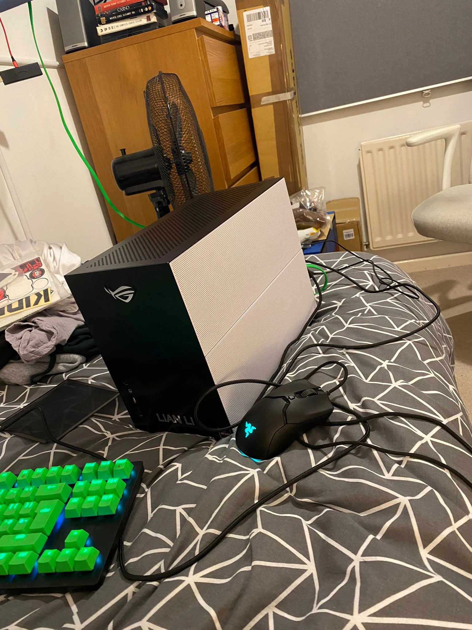

I present, the temporary skunk.
And I was indeed correct, FONV runs beautifully on the Nvidia GPU.
Right, back in spring when the weather isn't total anus and I can get my paint on.
