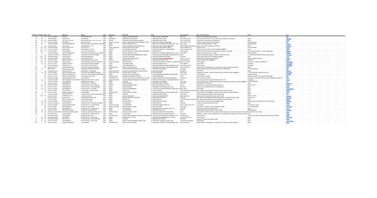

20 Oct 2002
5,557
This list was made on a German forum showing low power setups, might be worth a look-
