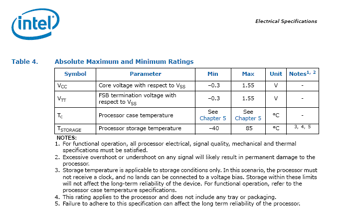

1.6v is a hell of a lot if its on air, considering Intel say the TMAX of the processor is 1.55v.
