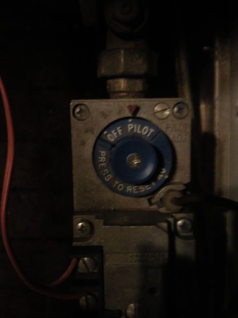

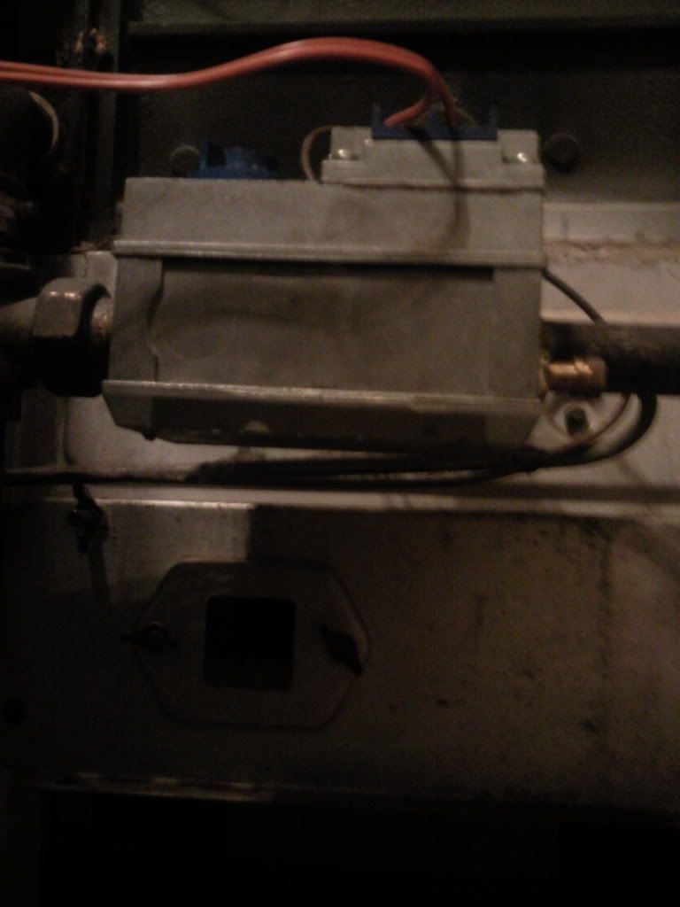

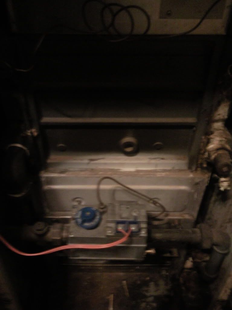

Glow Worm 45-60 boiler is dead. From what i can see the pilot light isnt lit.
Now ive taken the front off to have a poke around and i see the following:
Now i turned the blue knob around to 'reset', held it in...... you can hear gas hissing. Took my finger off it after 10 seconds. I didnt hear a 'click click' , ala gas cooker stove but then i dont know it im supposed to.
Any idea's? I dont have a clue when it comes to these things.
(turns on electric heater)

If thats the open flued 45-60 then it has to be relit with a lighted match or taper.
It MUST be relit with the electricity off.
Well.....not sure if its 'open flued' or not. We had a gas man around a week ago...he checked the boiler over....lit a couple of matches underneith to check the air flow but warned NOT to block an air vent in the kitchen.
So ...if in the morning i turn the electric off .....stuff a match underneith it? With the button pressed down?
Sounds open flued
Turn the elctric off at the fuse spur then hold the pilot down and whilst doing so hold a match near the pilot assembly in the boiler.
Once lit keep pilot button held down about 15 - 20 seconds then release and it should hold.
If it doesnt then it needs a new thermocouple and a visit from a gas man. If it does hold turn electric back on and your stat/controls to on and the main burner should light
Call a registered gas engineer to fix the problem before you blown yourself up and anyone else close by
Thankyou very much The One. I shall do this in the morning but il turn the electric off at the switch box because it'l be easier for me.

Actually, he hasn't. All he's done is remove the 'decorative' cover on the front. The knob to relight the pilot is a consumer control.
To the OP:
The pilot does indeed need to be relit using a match. That boiler is ancient, doesn't even have a piezo igniter. Hold the blue knob down in the pilot position to make the gas come through for a good few seconds before putting the match near to the pilot assembly to make sure there is enough that it lights (don't worry, it's hardly any really, no matter how long you hold it). After the pilot has lit, continue to hold the blue knob in for AT LEAST 10 SECONDS, I would go for 20, to be sure that it stays lit when you let go. Then just move the knob round to the normal operating position (hint: opposite way to "Off").
Should be an easy 2minute job, I wouldn't bother waiting until morning if you're cold.
