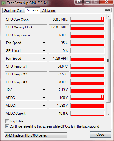

Bought this sapphire 6950 flex edition from OcUK yesterday and after reading it idles around 35'C and peaks around 65'C when under load i was worried when i looked at GPU-Z (see picture below)
i've been playing TF2 and although its not a graphics card crushed it peaked at 65.5'C so that was fine but it hasn't dropped below 55'C while idling and i'm just curious as to why this is so high?
anything i am missing with regards to setup or options?
thanks.
Is the fan control set to auto?
You are using just one monitor right?
Put the fan to 100% manually, let it cool down and see if it heats up again

it is running 2x Dell 24" monitors, both from the DVI ports at 1920*1200
The review would have tested idle temps with one monitor.
when you have two monitors, the clock speeds stay high as if you were gaming. 60 degrees is normal for two monitors.
Disconnect one of the monitors and only if you don't notice a change in temperature should you be worried. Obviously, give the card some time to cool down before doing this

i guess your analogy does make sense but i just didn't think it would make it 20'C hotter than standard, hope its not cooking my GFX to death =/
thanks for the help, after unplugging one monitor and turning the fan up to 80% its dropped to 44'C so not the 35'C others have been getting but not 55ish'C

cheers Xtrm2Matt, i was just concerned that's all that mine was a lot higher than what a few websites had state but now i know its working hard running two monitors it is to be expected.
