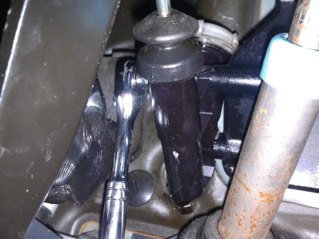

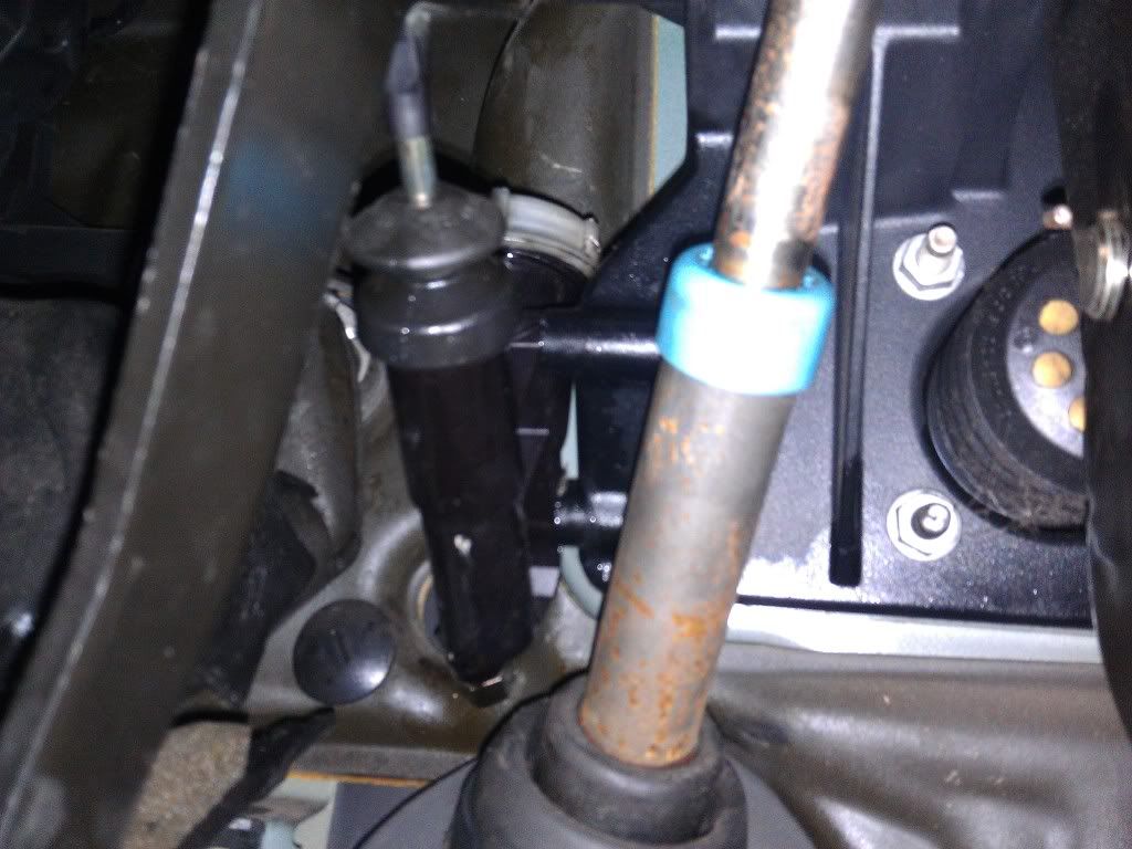

Today I tackled a proper **** of a job - replacing the clutch master cylinder.
It's original on 175k, feels a little ropey, and they're known for failing. All this added to the fact I'm going to Germany in this car soon meant it's time was up.
Original, in situ:
As you can see, leaking fluid quite badly. When I refilled and bled it last month, I cleaned it up to see if it was leaking - evidently so!
Absolutely zero room to fit a ratchet in - had to use my Draper slim 1/4 for this.
After about 45 minutes of fighting, I had the old one out. New LUK unit and old AP unit:
It seems the rubber seals had deteriorated inside the unit, as can be seen by this load of gunk at the bottom of the reservoir.
Working peachy now.
Total cost was about £110 for the parts, a garage quoted £300 so I saved a fair packet. :D
