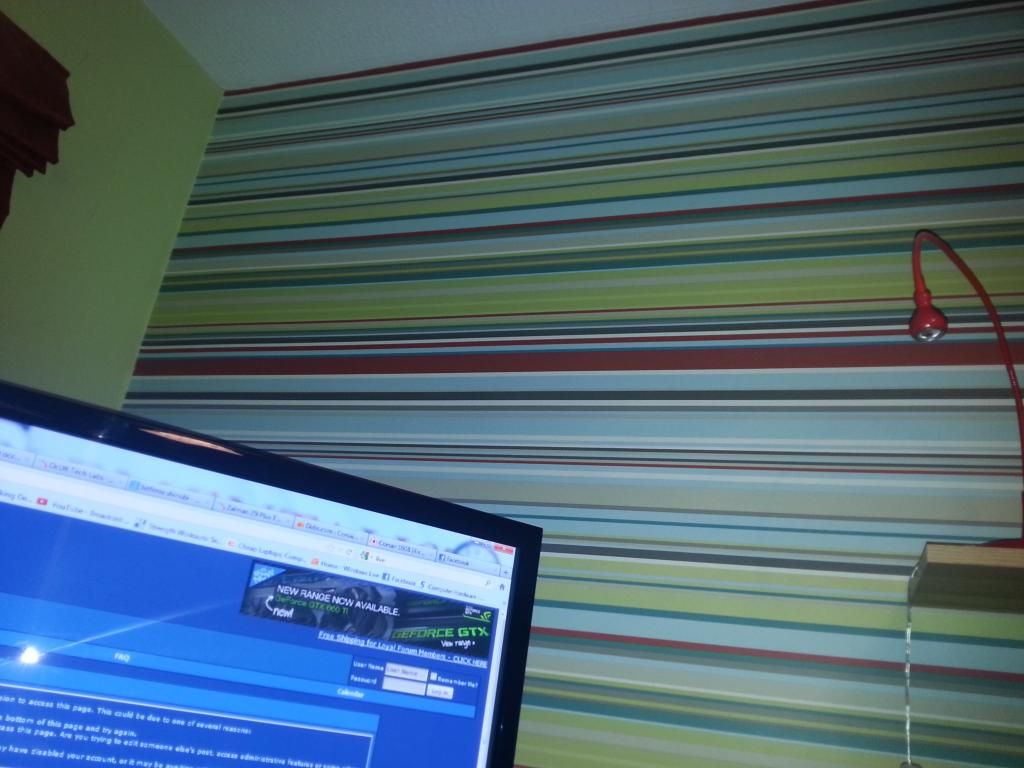

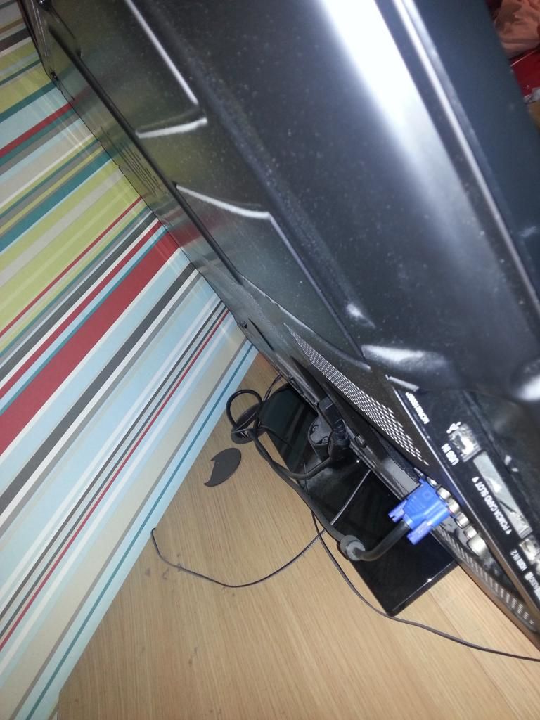

Hey guys thinking of mounting this tv to the wall is there any professional advice out there.
is it possible?
will it be too risky?
the tv is quite big the wall is definitely wide enough.
i am thinking about getting a wall mount which swings 180 degrees to allow me to move the direction of tv.
here are some pictures.

Find a stud and you'll be fine, keep drilling holes everywhere through plasterboard and it'll fall off.
I had my 50" on a stud wall for 2 years without a problem... I moved house before the inevitable "and then it fell off" comments. I mounted it to 2 studs and used wall anchors for the rest of the holes.
It'll be fine!
I did this only yesterday!!
Internal plasterboard wall, new build house. I'll post my pics and a guide tomorrow night if you like. Just let me know. You don't need a stud finder, depending on your wall or age of house they don't work.
It's VERY easy WHEN you know how to do it properly. Studs and Snap Toggles are a MUST
