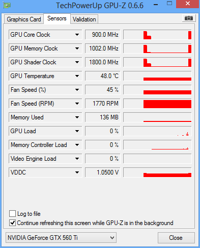

I have the built in front intake fan set at medium. I haven't tried with the door off, but with the side off, the max I've seen the GPU hit is 90°C. Currently got the PC on idle (just running Firefox and typing this message) with the door shut, side panel closed and top fan not working as it's faulty, this is the current state of affairs on GPU-Z
Fluctuating between 45° and 48°.
