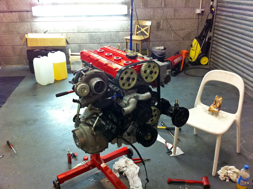

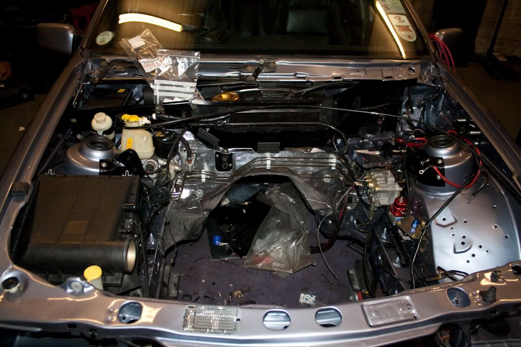

What started out as changing the sump ended up being a full engine rebuild and engine bay resto.
Engine stripped and inspected.

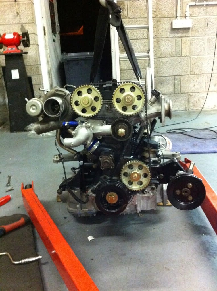

Building the engine back up. Head was skimmed and rebuilt with new lifters, block was rehoned, pistons got new rings and had valve cutouts added, crank was polished and the flywheel was refaced.
Pulleys/brackets powdercoated
More stuff electro plated
Head rebuilt
Tanks painted silver
Cam cover redone red

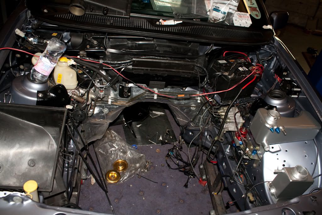

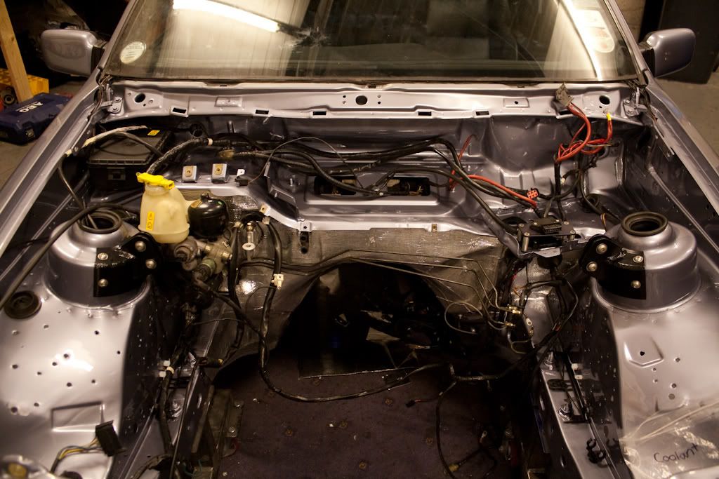

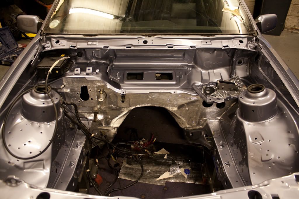

Then it was time to get the bay painted. Car was taken to a paintshop.
Upon it's return
Building it back up

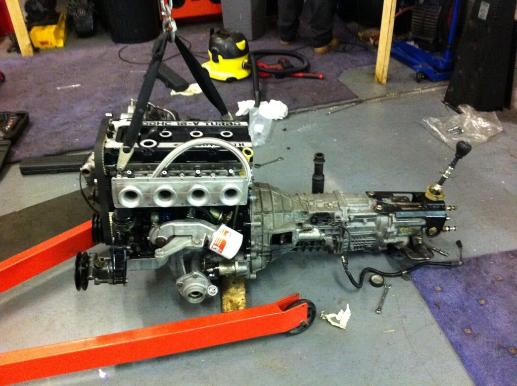

Engine back together
Bolted to the gearbox

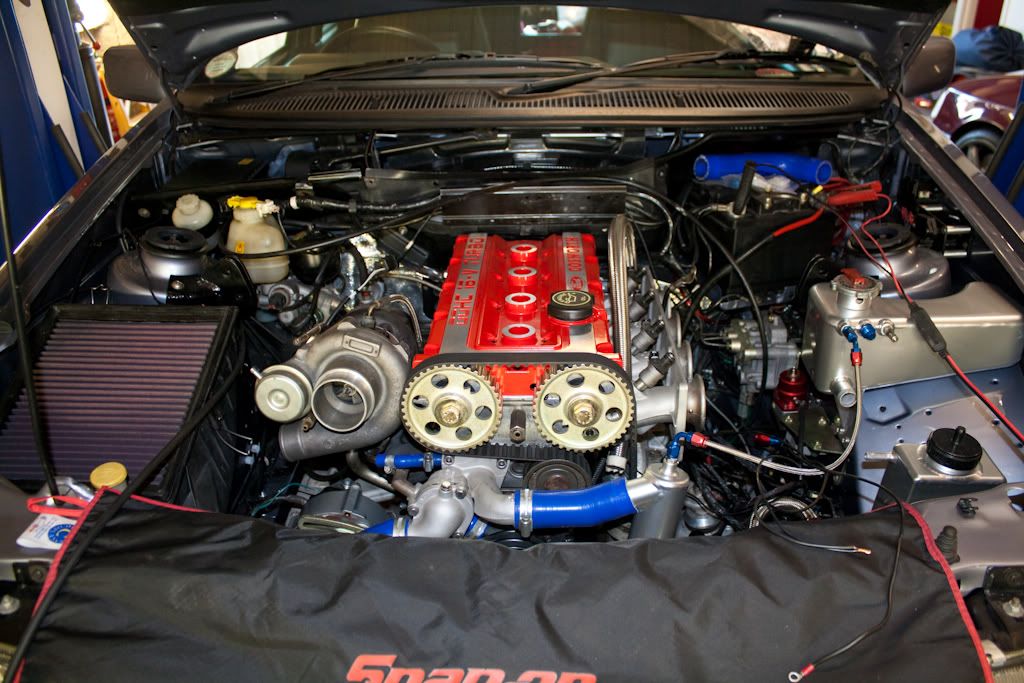

Suspension/Brakes refitted

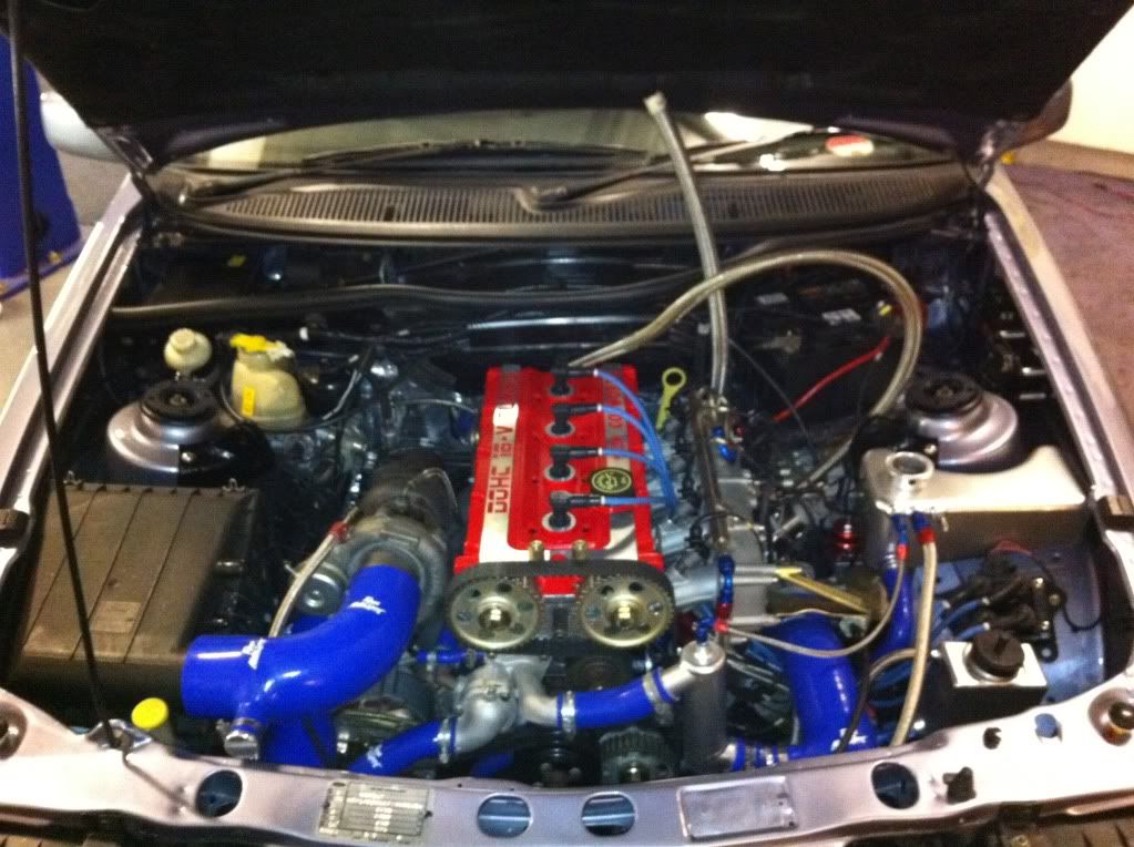

Engine back in it's home!
Video of the first start
[VIDEO]
Finished :)

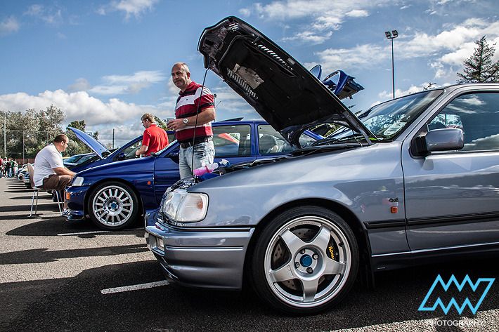

Random photo from a local show

Why does the cam cover go from red to black and then back to red in the next picture?
I set the red one on to see what it looked like and as it was freshly done I removed it and refitted the black one when I was refitting the engine to avoid any damage.
