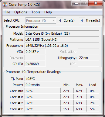

Got two of the piranhas delivered today. Installed on my k2 cooler and gave my system a quick blast with p95 small fft. 15 3570k @4.2ghz.
Max temps below.
At full speed connected to the cpu and cpu opt fan headers on my board, asus fan expert 2 reports them as running at.
1940 rpm
1875 rpm
At idle.
613 rpm
622 rpm.
At idle, theyre very quiet. At full speed, the noise is noticeable. But, it's lower than the noise produced by the previous dual 1500 rpm 120mm Alpenfohn wingboosts. Alpenfohn max temps below for comparison.
Not the most scientific testing by any stretch. But im pretty impressed with how theese perform.
