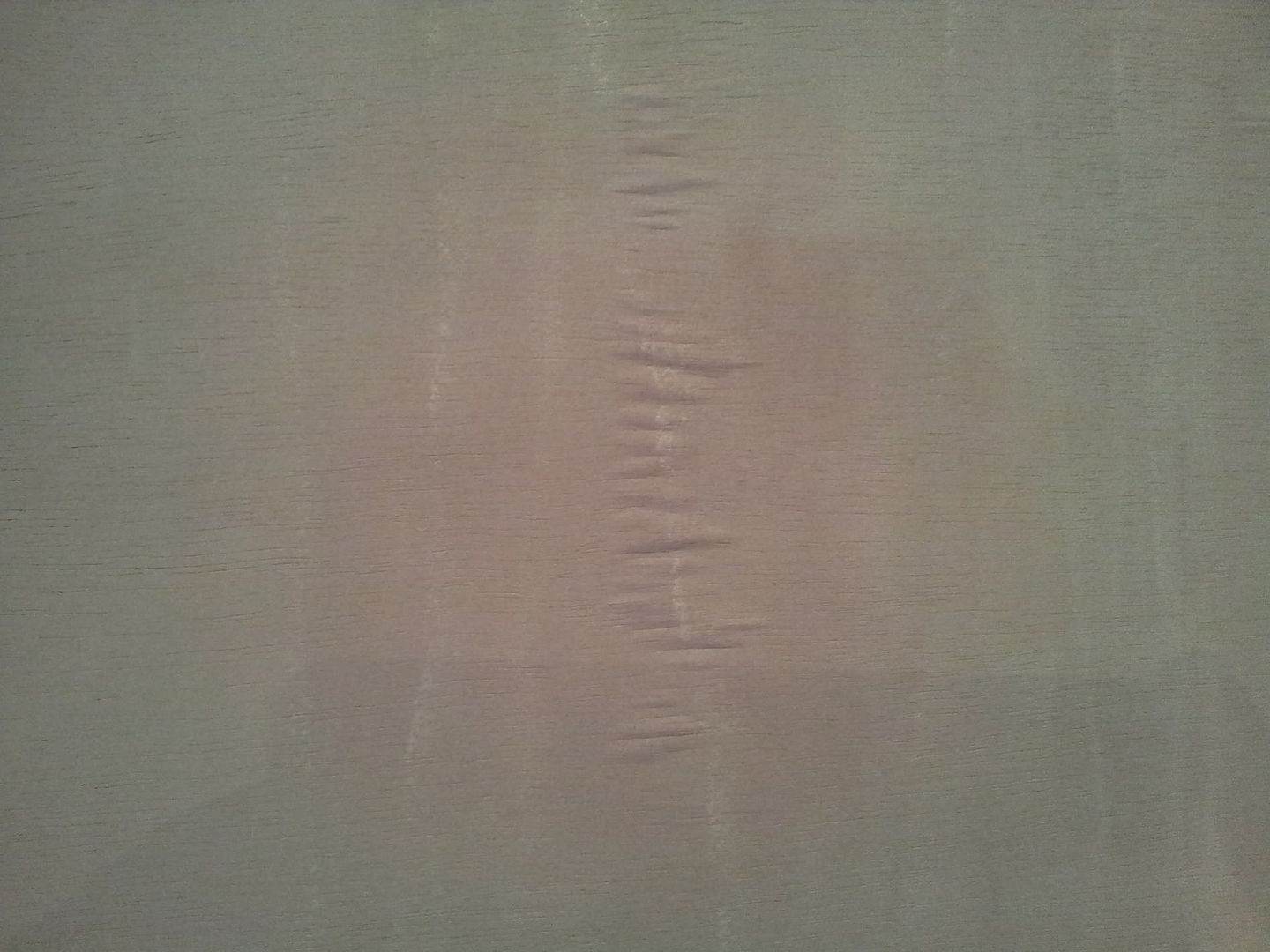

I bought a 10x5ft of plywood to use as a projector screen,.wanted MDF but they didnt have in that size. Any way after priming it, I have noticed some areas are showing some type of blister marks, see pic.
Wondering how to best get rid of them? Sanding and polyfilla maybe?
You will probably have to remove the bubbles, sanding them will push the layer in, and acheive nothing. Best bet is to remove the bubbles by cutting round them, fill them in, and then smooth it over. You will end up with a different finish though, as wood has a grain, and filler does not.

So I should take a stanley knife and actually cut the blister marks out, cutting around them, then fill and sand?
I would say its probably the wrong type of ply to be honest. You really need WBP (Weather and Boil Proof) as its external grade / waterproof and generally a better grade. To fix that you will need to remove the effected laminated layers, give it a good sand and then fill it with a decent 2pack wood filler. It then needs painting.
But truth be told its more hassle than its worth, just buy a new piece.

I will cut the areas out and polyfilla it and see what it looks like
Is it easy to take back down?
And if you push the "bubbles" will they flex in easily?
Assuming both yes then I would drill a tiny hole into each buble, inject some wood glue and place a heavy weight on each one that pushes the bubbles down.
You will then have a tiny hole to fill rather than a great big area.
What about covering the board with a quality projector screen material though. If you literally stick the projector material to your board you get the best of both worlds, the projector material and the true shape of a hard flat surface.
Scrape the bubbles out then fill with a decent timber filler but as above is it really worth it? you'll have a board with even grain then a line down it of smooth filler.

Sound like shuttering ply or Chinese ply, you plaster that, it will only bubble again or delaminate with wet plaster.
Work out cheaper looking for a local timber merchant who stocks 10'x5' 3mm or 4mm mdf, you can also get oversized MDF boards up 12'x6'
