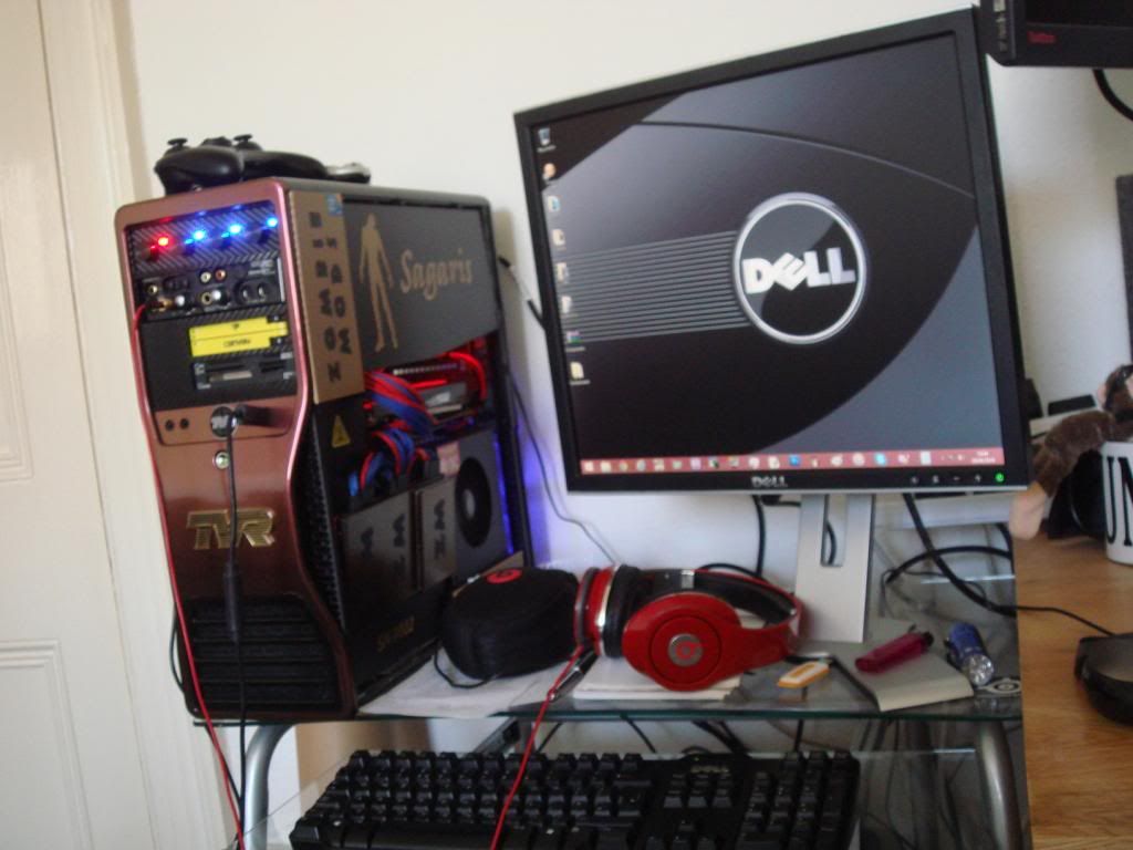

I would have to remove the RAID box I made (pic in a sec) and somehow mount the rad in that space should I go AIO.. Pic of the PC..
It's a very, very heavily modified Dell Precision.. The CPU is cooled by a H100 on Nidec fans running at around 15%. So it's very, very quiet and if I could in any way make it quieter then I will.
