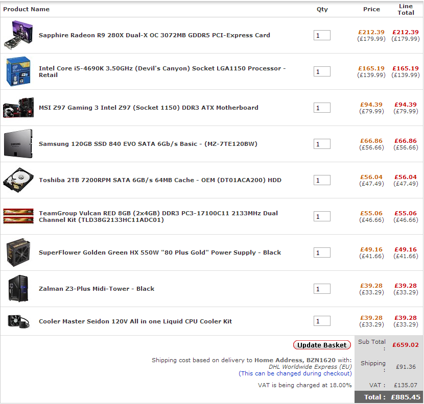

Hi all. My friend wants to buy a new PC and his PC knowledge is quite limited. I specced him the following
Basically, he wants it mainly for gaming.
I went for an i5 over an i7 due to its performance when gaming. i believe the i7 only offers performance gains when video rendering and stuff like that, things he does not do.
I really wanted to put a 280x in for him. he was looking at 270x and 280s, but I have to do everything to get a 280x :p For me, that is the baseline of a modern GPU. If you want it to last, you can't go worse than a 280x :p
Regarding the motherboard, I have no idea what to look for. I know it has the right socket and that it is Z97. It can take 2GPUs (future proofing right ;)) and has a good amount of USB ports.
I put in a Samsung SSD because people say they are the best. This Toshiba has better Read/Write speeds though and it is cheaper. Also this Kingston is quite cheap and it's read/write speeds are quite good.
He wanted 2TB because he has a lot of films and installs a lot of STEAM games. The price isn't too high so it shouldn't be a problem.
I went for 8GB because that should be just fine for gaming. 16GB is never really used unless he is video rendering or something similar. Plus they are red, matching the rest of the build! Also, Team Group aren't too bad right?
For the PSU, I was going to go with the modular Corsair 550W PSU, but due to the 280x upgrade, I had to cut the costs somewhere. Super Flower are quite good. I have the 650W version of that PSU and it's good.
The cooling I just put in the Seidon 120V. I have that AIO cooler and it works ok. It's cheap, which should leave some more headroom for the cost of the 280x.
The case was just put there as reference as it will be bought locally. Ordering a case will increase the shipping cost by quite an amount, so it has to be bought locally. Local shops don't have a great choice either.
What can I change? He doesn't need any peripherals or OS, just a base system.
Anywhere I can cut costs and still keep the performance? Budget is around €1000 (£800), maybe a bit higher, but definitely around that mark please (build is a tad higher, hence why I am asking for cost cutting).

Try this build in your basket, and see what the shipping and VAT come out to. I have a feeling the shipping will be slightly under what it is with a Z97 mobo and the Zalman case. The SPEC-01 has very good build quality (see vids/reviews) for the price, and a few advantages over the Zalman (once you add extra fans).

@RJC and Danny75,, I don't see how your builds are any cheaper, when you factor in the extra shipping costs. As I am sure it will cost more then £8 to ship to Malta.:p:D
Mine has a Z87 on offer (that comes out at £23 cheaper than the MSI Z97 Gaming 3, as it lessens shipping costs a bit too).
And shipping should be £73 (with SPEC-01 case), compared to OP's shipping of £91 (with Zalman Z3-Plus case).
So there :P

And bear in mind the Malta VAT is 18% not 20%, so would be cheaper, if shipping cost remains the same as for Gibraltar (which I think it will as I came up with the exact shipping cost as The Malteser, when I entered his basket into my account). I calculate what he'd pay for this would be £826.80 compared to his spec of £885.45.

I believe the PowerCooler 280x is a reference card, and it runs a bit warmer than the after market cards. With a small case, with not the optimal airflow, I would prefer something that runs a bit cooler.
The case adds quite some expense in shipping, but then again, the same Zalman case is much more expensive from here (double the price!), but it still turns out s bit cheaper.
The one I specced isn't a reference card, is a bit faster than the Sapphire, and has a backplate.
