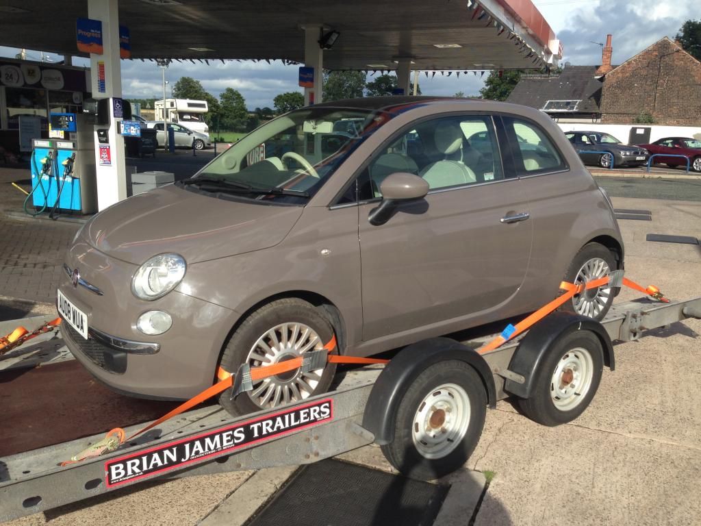

Here is the car 08 Fiat 500 1.3 Diesel Done 50k with full fiat history. Got AC,alloys, full glass sunroof bluetooth, etc
I paid £3450 for it , ok not the best colour but just bought it to fix it

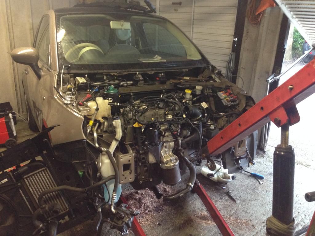

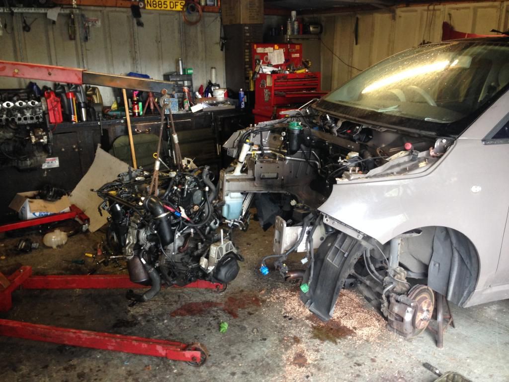

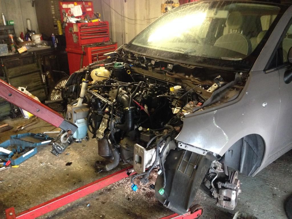

Anyway Sunday night we set to take the engine out and was a east job to be fair. We Decided to take the front end off as it made life very easy to get the engine out. Took just over 3 hours and was out :)
Here is a few pics as to what a fiat 500 looks like with no engine :)

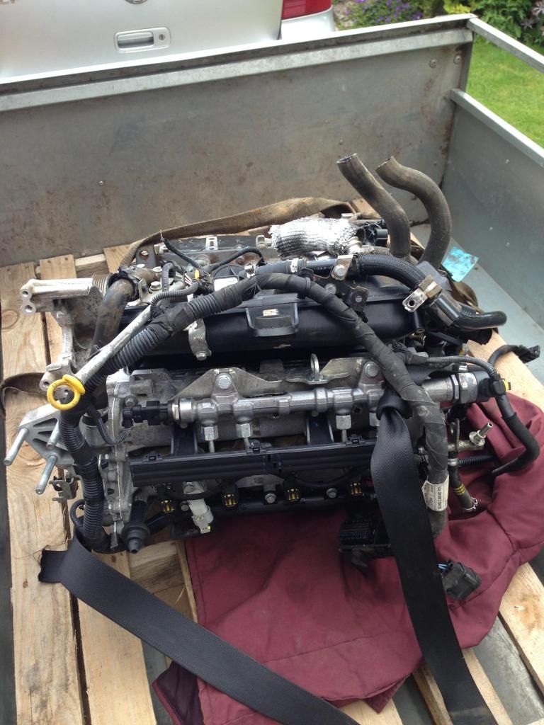

After getting it out i needed to start looking for a engine. So looked in various places ebay etc and for the love of money could not find the same engine " Fiat 1.3 mutijet" Its basically the same engine whats in a corsa/combo van. I was going to buy one out out of a corsa but i have been stung in the past with the incorrect engine. After a few days i finally found one.
Located from a Fiat breakers in leeds for £700.Came from a Fiat 500 again but 2010 what had done 40k.
