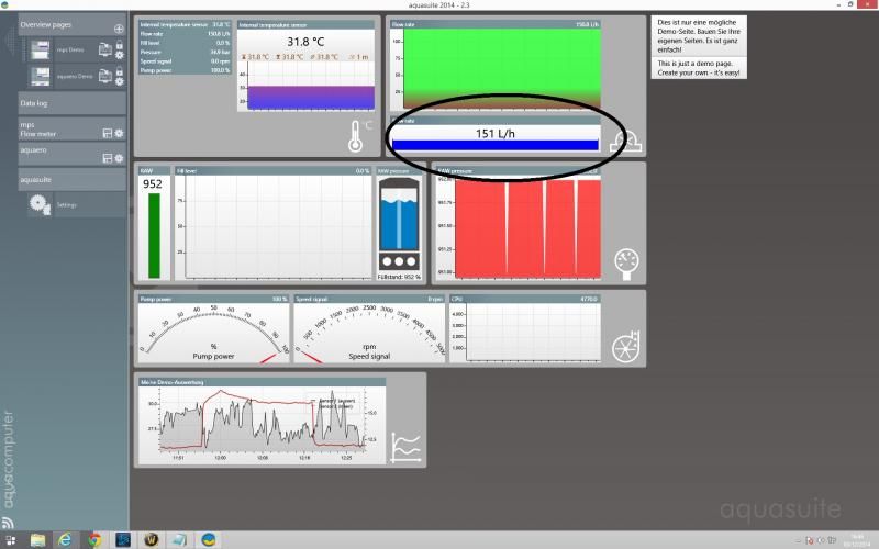

When in aquasuite 2014, i click on the mps demo, set it to lire per hour (via aqua suite 2014 settings)i get the below readings in the circle.

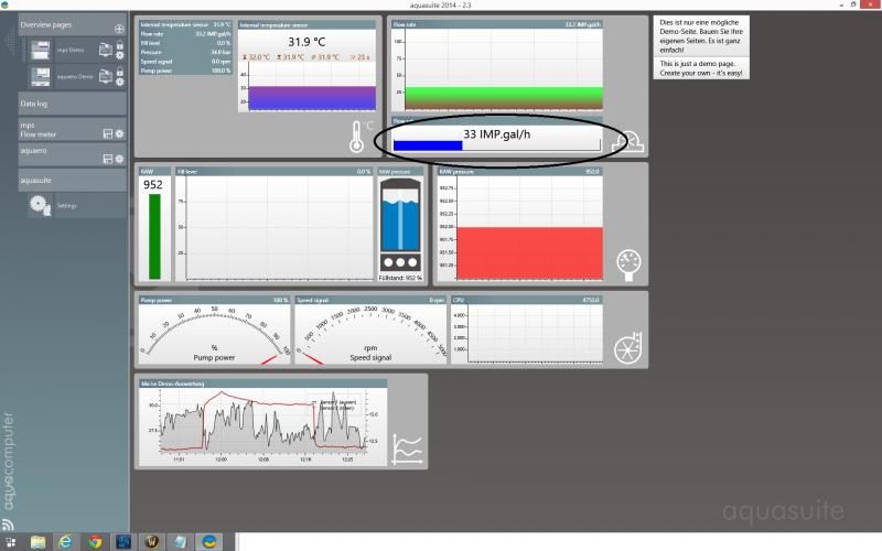

Now when i change from litres per hour to uk gallons per hour. i get the below readings in the circle.
