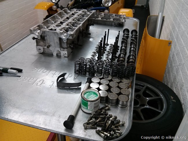

First of all - I broke it. The little 1.6 litre Rover K Series motor had long been running the factory 'Supersport' upgrade which consists of hotter cams and an ECU update. Part of the difference with the map on the ECU is to raise the rev limit (to take advantage of the cams), but the problem with doing that is the standard pistons really aren't happy bouncing up an down so quickly. Eventually they fail, and after a fairly spirited session at Silverstone (video here) I discovered I had one cylinder with much less compression than the rest.

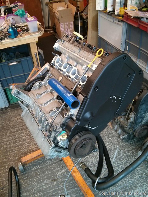

Cue some light disassembly to discover a failed ringland on number 1. I pulled the engine out and took it all to bits and sulked for a while, until I got lucky and my engine builder had a slot in his schedule to get it all sorted. It was rebuilt with uprated cylinder liners, modified rods, forged pistons, some head work, and uprated valve springs and the like. The idea was to build a sensible spec to prevent issues with future use and upgrades. By this point it would have been making something like 135-140hp.

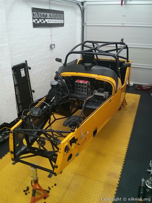

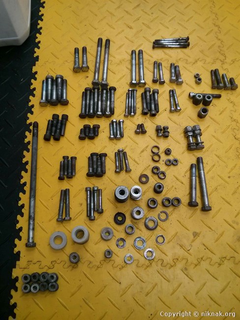

A few more months down the line and it was time for another full rebuild of the car (minus engine!), this time at the 80,000 mile mark. I ended up going further than usual and replaced virtually every single nut and bolt, as well as the usual fixing up and/or replacing of other components as necessary. Dampers were serviced, gearbox and diff were refreshed, and everything got thoroughly cleaned. I particularly enjoyed the process of reassembly using new hardware - almost like building a new car.

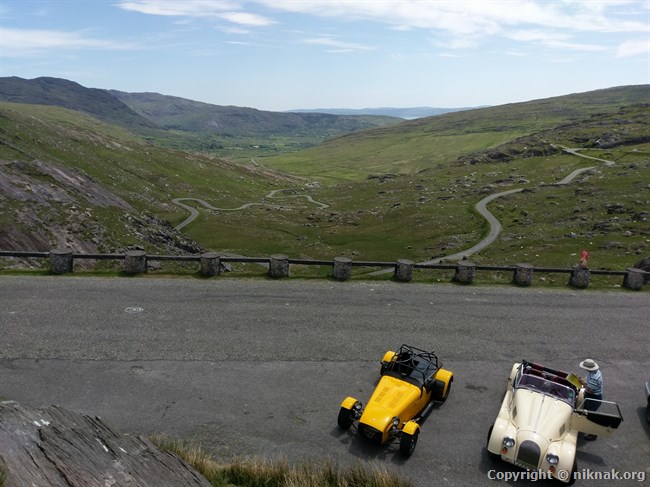

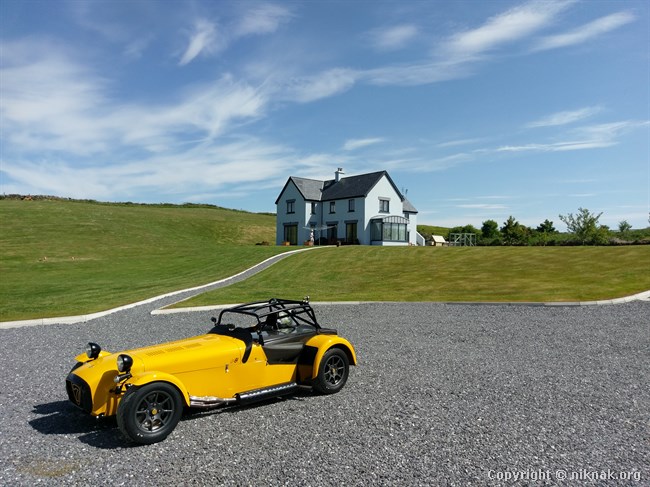

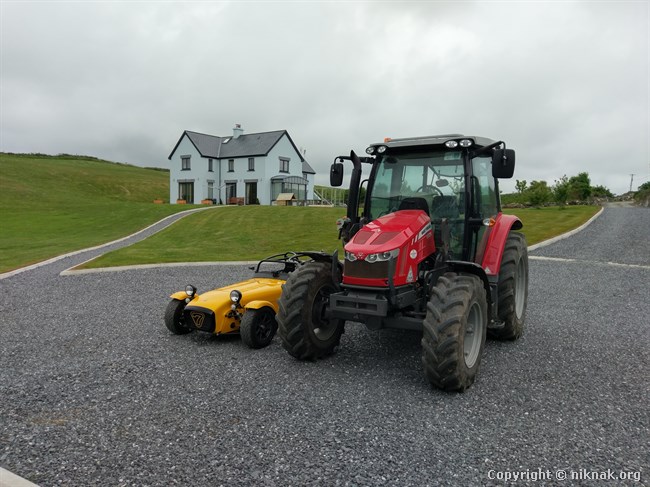

Once that was completed I visited some family on the south west coast of Ireland and put 1,269 miles on it. Some spectacular scenary and roads (and some dire ones too!) and great people. Not the best car for a road trip but quite an experience! I made a short video of the Healy Pass (video here) which was great fun to drive, and once again confirming my theory that a Caterham would make an awesome tarmac rally car!

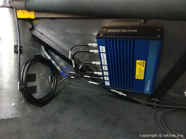

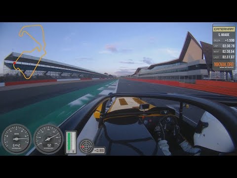

The next step was to scratch an itch I've had for quite a few years and fit some proper video data logging equipment. So I installed a Racelogic VBOX HD2 kit, including live dashboard read out (primarily used for lap delta on track), and hooked it up to the CAN bus output from the ECU so I could record as much as possible (as a software developer by day, data is sexy!). After a few integration challenges solved by some in-depth troubleshooting with Racelogic and Emerald (ECU manufacturer), I'm now logging all of the interesting engine params (engine speed, throttle position, coolant temp, intake temp, etc etc) as well as brake line pressure. Combined with the positional information of the car and the speed and so on, it all helps to build a clear picture of where time is won and lost and how I can improve - exactly what I wanted. You can also use it for recording performance data, like 0-60mph times - 4.23 seconds now - with graphs!

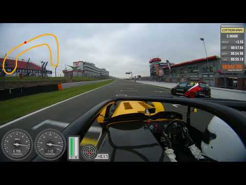

Finally, to celebrate 10 years with the car and give the data logging a proper test, I spent a long weekend doing track days at Brands Hatch and Silverstone. I set new personal bests at both and, thanks to the VBOX, discovered heaps more potential in the car. With a few more clear laps next time I'll be going even quicker. Brands Hatch was fun as it always is, although it did nearly go very wrong...
...but Silverstone was absolutely mega with that little bit of extra power. When you can see the delta getting bigger and bigger for most of the lap it's great but piles on the pressure!! Very entertaining though, and that's what it's all about.

I've got a couple of videos up from those two most recent track days and I've tried something new by adding a bit of commentary to them. Let me know what you think.

Good save at Brands as well!
Cheers! Genuinely thought I was going to at least side-swipe the barrier but managed to get away with it :D

Ah that's really cool, thank you! I had a lot of difficulty getting the CAN bus connection working properly with the Emerald which turned out to be something really simple in the end. The support system is great but we decided it would be easier to diagnose the car directly so I came up and visited back in in May last year.
C--z8IfXsAAwyT6.jpg:small
Had a good chat with the chap who helped on that day, Jon Holman. He mentioned a few things were in the pipeline for the HD2, I'll PM you and see how that's going.
Have to say though, it's a brilliant piece of kit. Very well made, well engineered, and well supported. It was an expensive purchase but I've got a lot of faith in the company behind it having had a few minor issues sorted out very well. As a .NET developer it's a pity I live too far away to apply for a job ;)

Where you lost it at brands (surtees) you should be going through almost flat, you had lift off oversteer :D Took me some time to get the bottle to try it!
Nice write up
EDIT:
Yup you're not wrong!! In fact in that clip I was still left-foot braking. Caterhams are tricky to get the nose in on power, they like a bit of weight transfer, and later on in the day after some practice I was just lifting for the entry to Surtees and carrying lots more speed.
I had the same 'issue' with the car to begin with at Silverstone, just that feeling of understeer building. But in the end I just used more steering input and it actually did grip and corner well. So after that learning experience now I'm thinking I should be able to either lift less or just hook it into Surtees at full chat. What could possibly go wrong... :D
Probably need to change the ride height, make sure the front is sufficiently low, keep more weight over the nose.
It is flipping scary the first time as it goes counter to all your instincts, but it is a great place to overtake!
